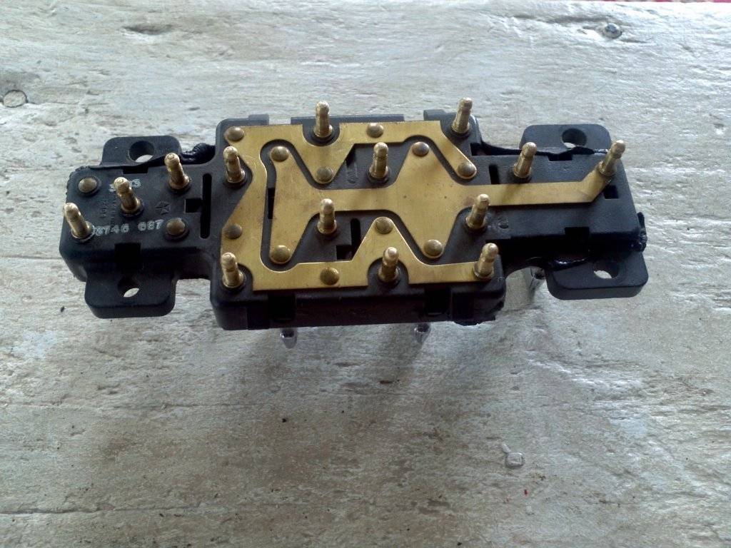

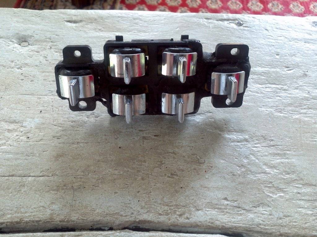

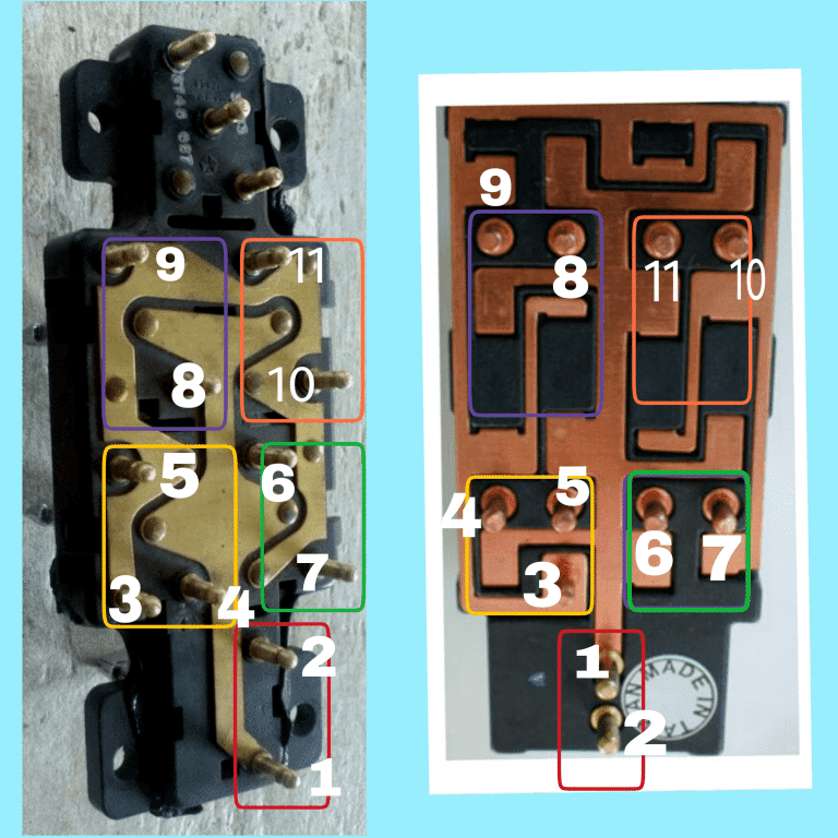

Anybody else thinking what I am thinking???
You need a total of six switches
but I only see Five on the Taiwan Ford one ! :poke: hmmm :drama:

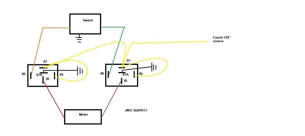

I'm sure that the location is part of the problem. I'll bet those switches get soaked when you open the door in the rain. We can take the load off the switches with a simple relay system though.
I've been playing around with the idea of doing just that for my car. I sketched something up a while ago and was gonna post that... and then I realized I was probably the only one that could read my mess. So I did up something a little nicer.
You would have to run a fused 12V source to each door and splice into the wires at the window motors. 2 relays per window.
As the 2 wires coming from the switch are going to be a different color combination for each window, a little detective work with a test light will be in order to know which relay gets the purple and which gets the red wire.
I know there's a relay kit available that will do this... But this would cost $50 versus $300 for the "kit".

Cool.
Disregard earlier comment... my head popped outa my arse and I see the logic.
I had to check or I wouldnt have slept tonigh. :p
Should work if you splice the Ford connector to the Chrysler harness.

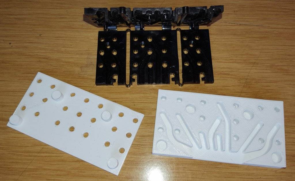

I'm indeed working on something that would help you with this and it's a 3D printer involved ;) But it's only an early beta version right now. I will post more about it when it's done!
