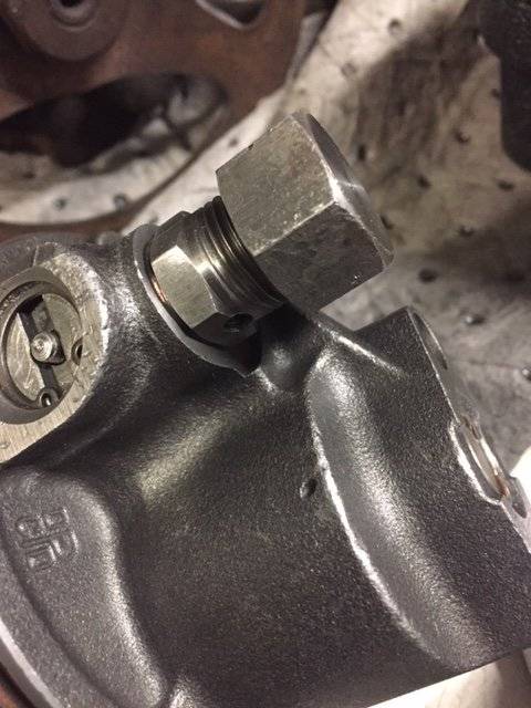

Anybody know if this can be done out of car? I took mine out to rebuild and didn't have a service manual at the time. Now that I have one it notes "Do not attempt to readjust this valve". Thanks.
Anybody know if this can be done out of car? I took mine out to rebuild and didn't have a service manual at the time. Now that I have one it notes "Do not attempt to readjust this valve". Thanks.View attachment 197178
This is a preset item, screwing with it can blow the seals on your steering gear and void the rebuilder's warranty. It can also cause erratic steering. If you think it is not properly adjusted, return it to the rebuilder to be reset. What problem are you having with the gear that you think the relief is not properly set? And for which year and model car?
