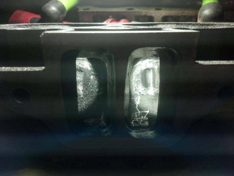

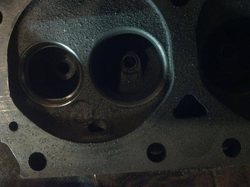

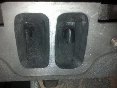

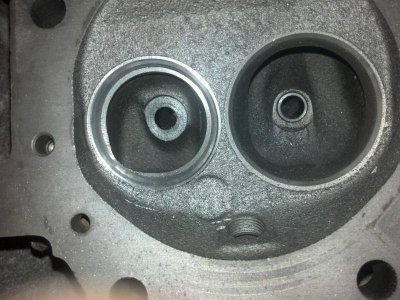

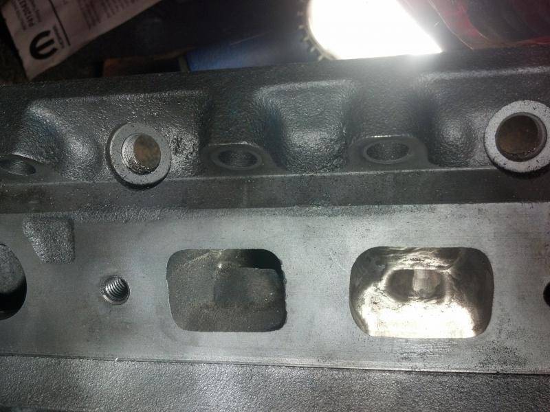

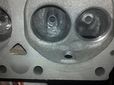

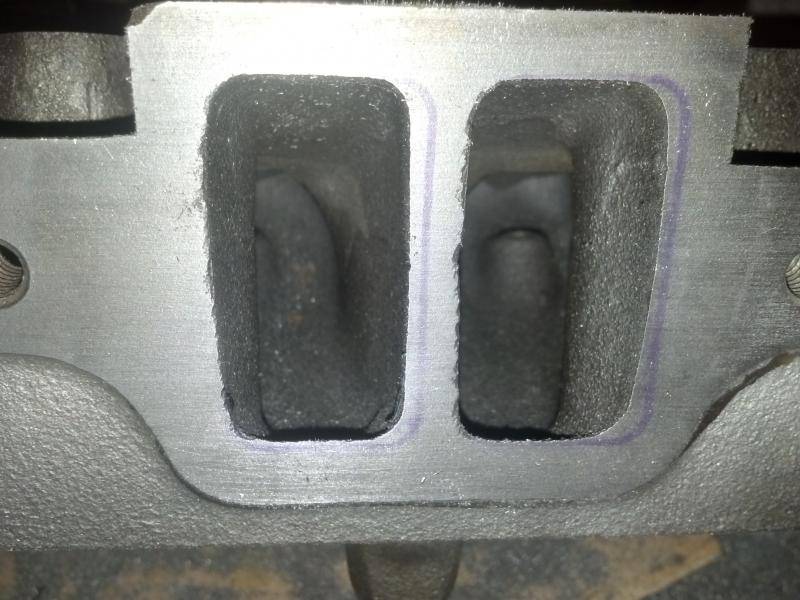

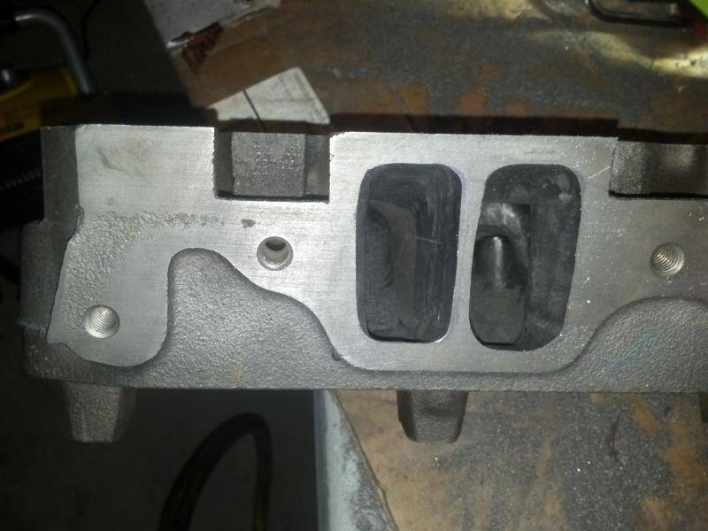

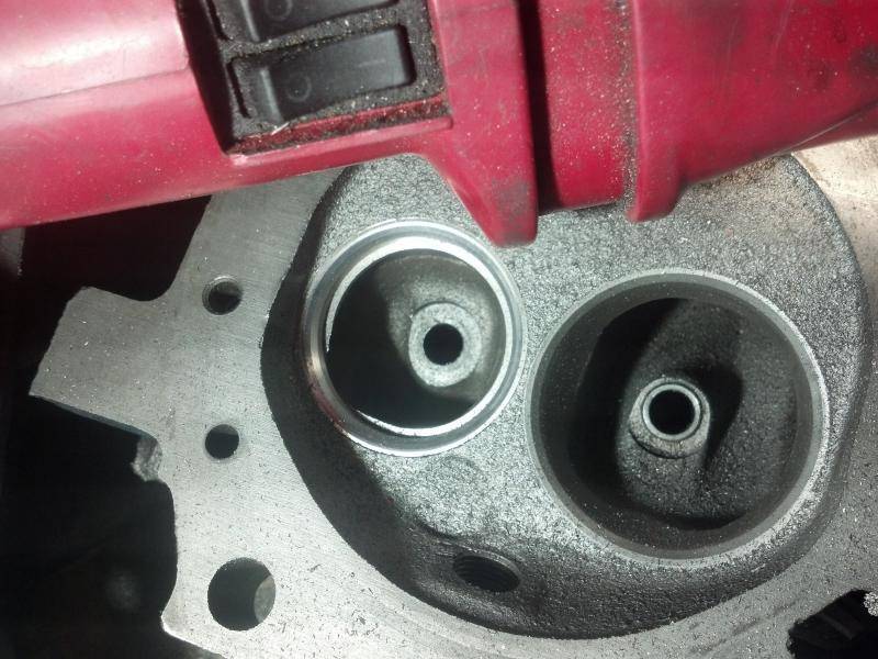

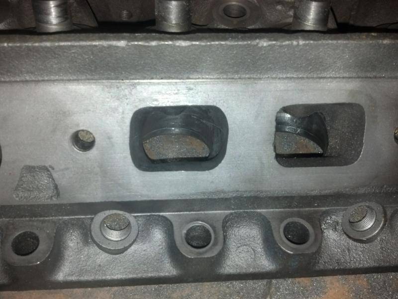

Spoke to the machine shop today and got my heads back after then hardened seats were installed and new valve guides. Blocks been bored with a deck plate and the cylinders cleaned up to what I wanted, so I can run the 4.375 bore. The crank will be machined next week so that'll give me time over vacation to port the heads. Then its back to the machine shop for the valve job ect. I finally get to order some more parts! I'll be going with a dished pistons, moly rings, new harmonic balancer, and a cam when I finally decided what to run. Things are looking up so if all goes well by the end of next month everything will be balanced and put together. With a little luck the new motor will be residing back where it belongs snug in the fury's engine bay.
