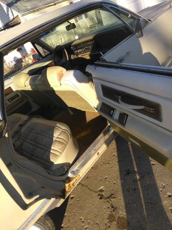

Jan 29, 2021 #1 McPherson 57 Member Joined Aug 22, 2017 Messages 170 Reaction score 81 Location Michigan Will sedan and hardtop interior door panels interchange?
Jan 29, 2021 #2 MrMoparCHP Old Man with a Hat Joined Aug 9, 2013 Messages 5,830 Reaction score 5,899 Location Lompoc, CA What year? assuming 4-door in 69 the fronts are different, rears yes the fronts have an extension to cover the b-pillar Alan
Jan 29, 2021 #3 McPherson 57 Member Joined Aug 22, 2017 Messages 170 Reaction score 81 Location Michigan MrMoparCHP said: What year? assuming 4-door in 69 the fronts are different, rears yes the fronts have an extension to cover the b-pillar Alan Click to expand... 73 ply
Jan 29, 2021 #4 MrMoparCHP Old Man with a Hat Joined Aug 9, 2013 Messages 5,830 Reaction score 5,899 Location Lompoc, CA Actually I have that backwards, the fronts are the same, rears are different. Alan
Jan 29, 2021 #5 MrMoparCHP Old Man with a Hat Joined Aug 9, 2013 Messages 5,830 Reaction score 5,899 Location Lompoc, CA This is a New Yorker, the rear panels on the hardtop cover the b-pillar where in a sedan they do not. Alan
