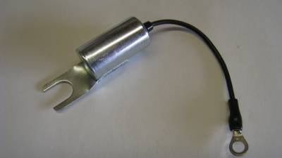

There's a few things that can cause this, particularly on the AM band. You didn't specify if it was AM, but I'm going to assume that.
Spark plug wires can be a problem, especially if they are solid core wires. There should be a suppressor on the coil too, most times those are missing. Looks like this..
There are other things too... Bad ground for the radio and sometimes a bad antenna connection can make it worse too.
