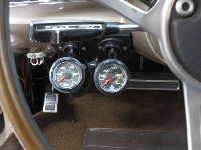

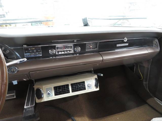

Not a three gauge set-up, but here is where/how I mounted two gauges on a '65 Newport w/add-on A/C.
I have since squared off and shaved down the mounting pad by 3/8 "
