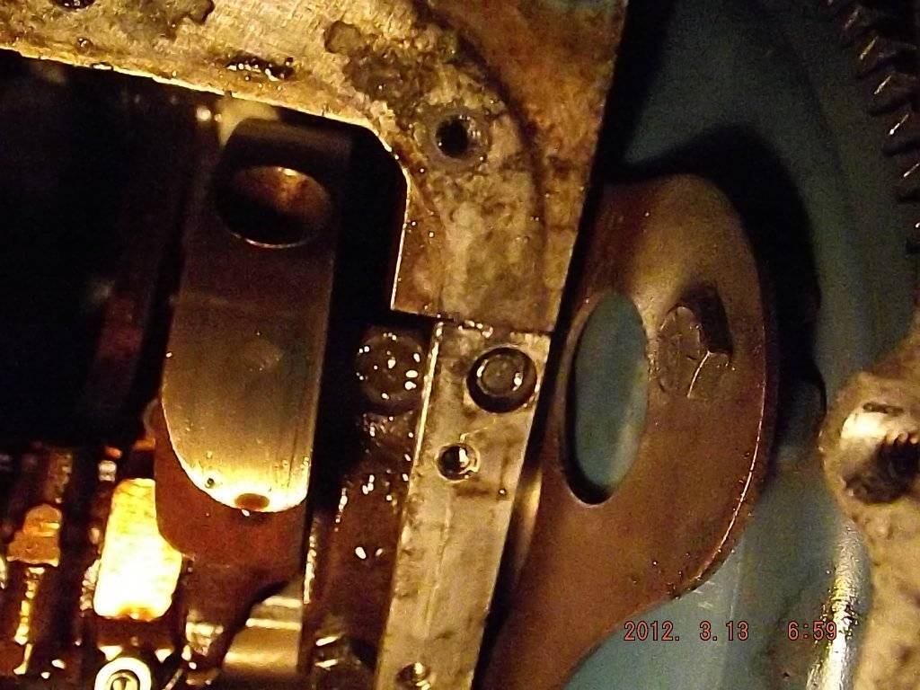

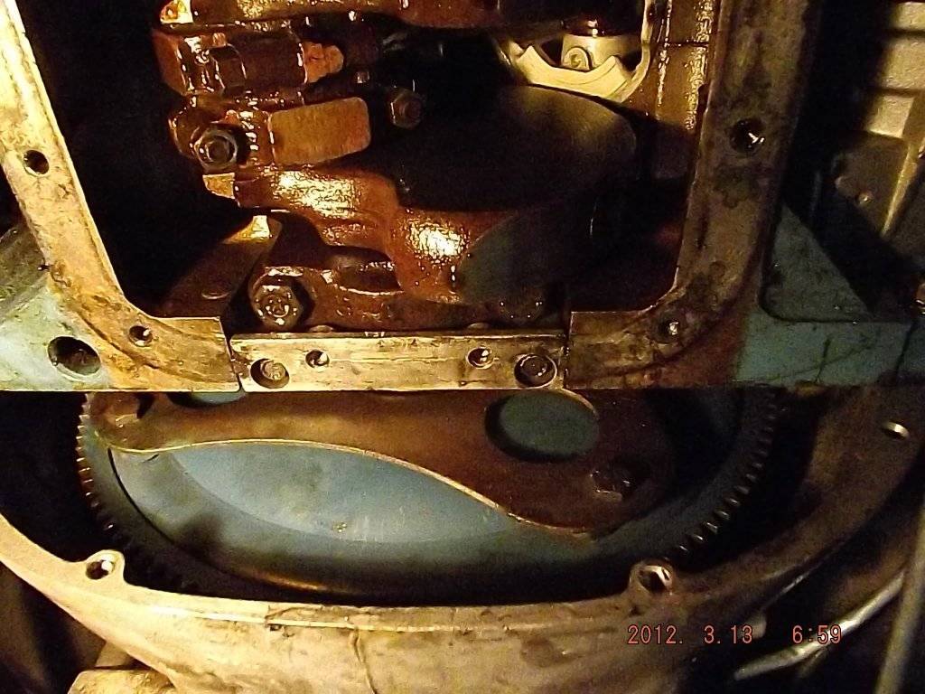

Well I got the oil pan off and there are two bolts I cannot get a socket on. I look at them and say "Should be a piece of cake!" Can someone tell me what socket is needed. I even turned a socket down to get in there and no luck.
I thought it was a 7/16th or 10 ml, the car is too old for metric!

I thought it was a 7/16th or 10 ml, the car is too old for metric! View attachment 75335 View attachment 75336
Lol, I used a 3/8ths drive socket today to put two in on my engine, I can't remember what size it is but it is smaller than 7/16th's. I'm pretty sure 3/8th's is the size but don't quote me.
I GOT it done! The problem I was having was the number of points on the bolt did not match the number of points I had on the socket. I finally found a multi point deep socket 3/8th or 7/16th and it worked. I retired and I think this is the first time I ever had to work on a bolt with so many points! It is done!
