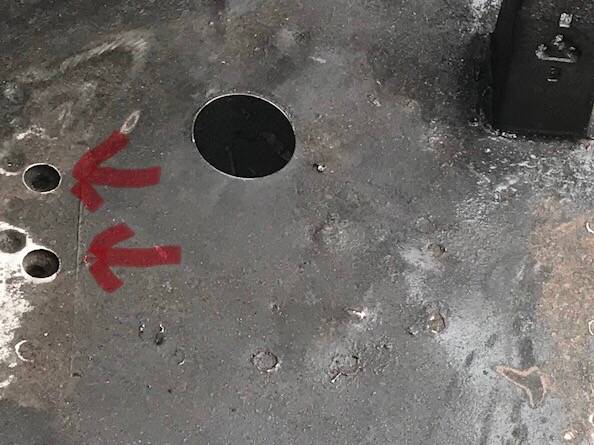

I need both left and right. I’m not sure what to call these, I couldn’t find a reference in the parts book, but my best guess is “rear seat lap belt reinforcement bracket - outer”. These bolt to the floor and then the belt bolts to the bracket.
The first pic are the bolt holes in my floor pan, the second is the best pic I could find of one in place. Please take a look and let me know what you have. If I can’t find originals I could probably mock something up, but would need measurements.
Thanks in advance!

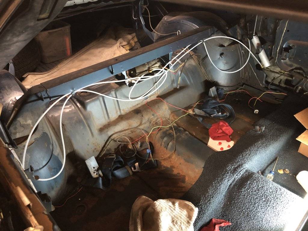

I just finished doing the interior in my'70 Newport. My rear belts had no bracket; the stud went through the belt mounting bracket (with the belt attached) straight into the hole. Nothing else.
From your pictures, I really don't know what I'm looking at or for.
This is my 69 Polara 500 (the sedan was the same), belts just bolt to the floor.

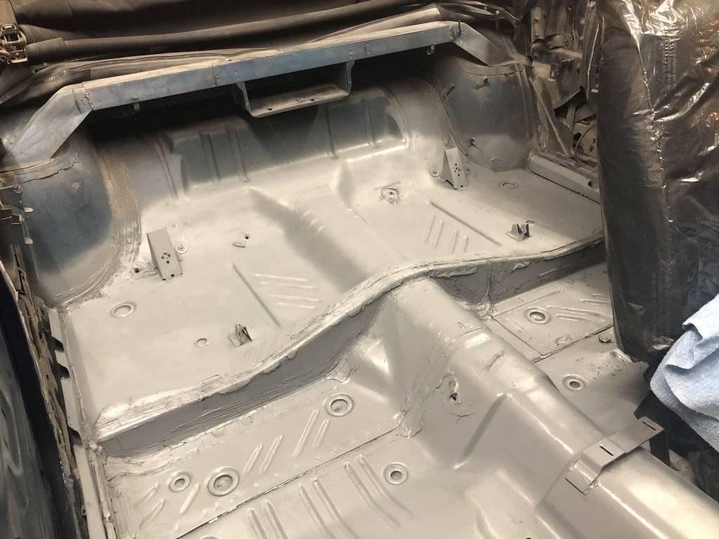

Thanks Alan, mine is definitely different than what you show. There is no “outboard” bolt hole provision other than the two holes I show in the first pic. After looking through the FSM and the Assembly Manual, I’m thinking that the ‘70 with the bracket is a one year, convertible only piece.

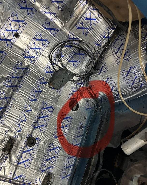

A couple bad pics with the belt bolted on. The Boss POS is gone if anyone cares.
I see it, thanks. It has the plastic sleeved seat belt, I think the ‘69 was all cloth. I’ve looked through the parts book but can’t find a part number, yet the bracket is clearly pictured in the assembly manual. I might end up making one since bolting the plastic sleeved belt directly to the floor will not work.

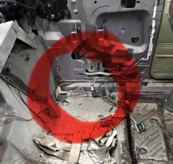

I hope this is a clearer picture, before the sound deadening was put down. The two red arrows are pointing to two bolt holes at the edge of the floor near the quarter window. That’s where a bracket would bolt to and then the seat belt would bolt to the bracket.
No. mine are nothing like that. Mine are like the bottom picture of Mr.Mopar's images: two holes on each side of the hump for mounting the belt, and then one on either side of the seat area for the short connector. Sorry I don't have a picture of them.
My second mounting hole is underneath the carpet on either side, close to the door opening.

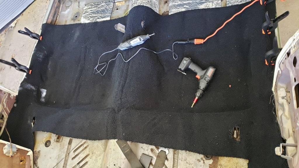

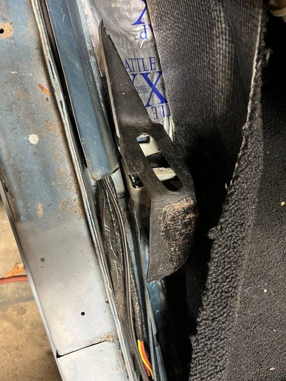

I wouldn’t have thought they were different having similar build dates. I like the way you did that with the clamps. How did you deal with the front seat retractable belts near the door sills? I still haven’t figured out how to attach the plastic shield piece.

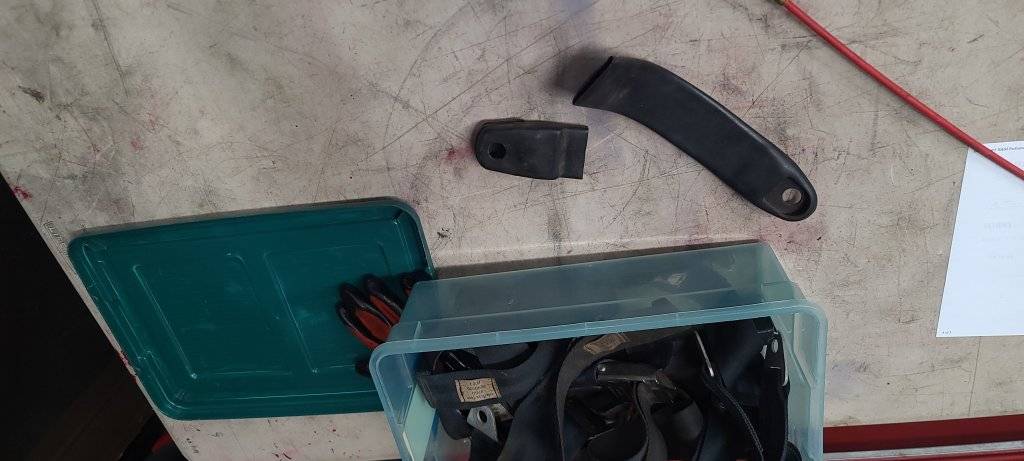

@Samplingman Are these the plastic sleeves you're referring to?
I've got 1 of the longer sleeves and 2 smaller sleeves.
