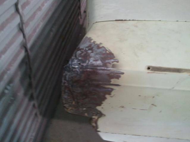

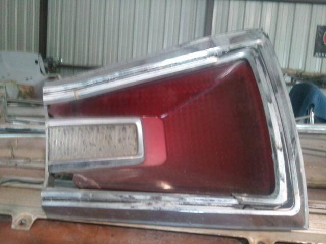

No you can't ignore her....or it may be the doghouse for you. I understand her concern being a mom myself. Here is something to think about. If you get hit by one of the newer cars..your car might end up with a scratch. Here's what a Kenworth did to me in 1978. (I was stopped and he hydroplaned into me). 2012-09-15 13.30.06.jpg2012-08-021.jpg
Barely crunched in the corner of the quarterpanel and slightly damaged the taillight. I used a chain to pull out the guys bumper.
