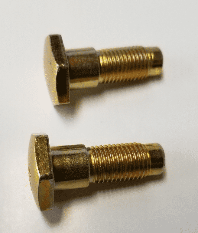

Option B is better (IMHO) but I would use regular Chrysler bolts (IIRC 7/16-20) as they have a shoulder that the belt bracket would ride on. No nuts, just use the existing threaded plates in the floor.
I emailed Vans on ebay to see what they think. If not I may make a trip to the hardware store and see if I can find a grade 5 bolt that threads into the floor and has the appropriate shoulder.

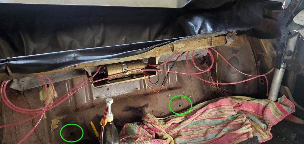

Got three seat belts delivered from Seat Belt Planet and they seem to be of great quality. Now the problem I have is I cannot find the outer seat belt mounting points.
It looks like someone replaced the floor pan at some point and I cannot locate the outer holes through the floor. I looked in the FSM I have but wasn't able to deduce where the outer mounting location is in a convertible.
Anyone have a picture or illustration of how the belts mount on the convertible? Specifically the outer mounting location.
In the picture below you can see the two threaded holes I can find.

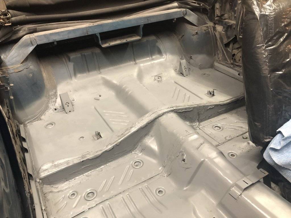

Well shoot, that was my fear. Thanks for confirming and for the pictures, Alan! I'll confirm but from what I recall these holes don't exist. My best guess is the floor was replaced with one designed for a hardtop which probably had shoulder belts so no outer holes. Might need to start drilling and fabricating a backing plate.
Drilling holes in the floor is not something I look forward too.

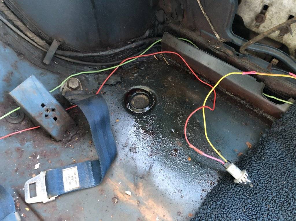

I found the original mounting plates for the outer seat belt attachments. When the floor was replaced they didn't account for these mounts and just covered them up.
The passenger side bolt was still installed but they cut the head off and installed the floor pan over top. Now the fun begins trying to remove the stud they left installed.
The driver side outer mount had no bolt so that should be as simple as drilling a pilot hole from underneath and then drilling a larger hole to expose the threaded mount.
Thanks again for your help finding these, I wasn't excited about drilling a hole in the metal without some kind of reference.
