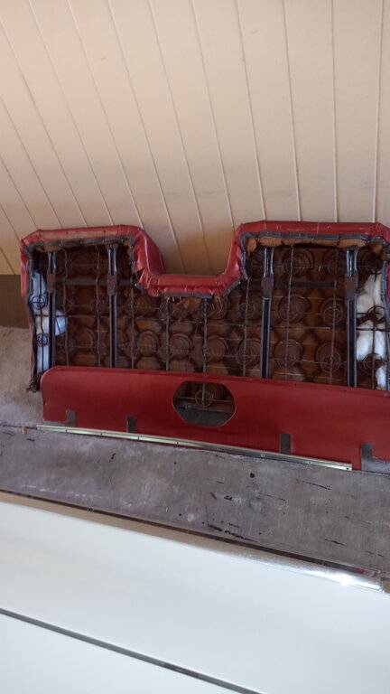

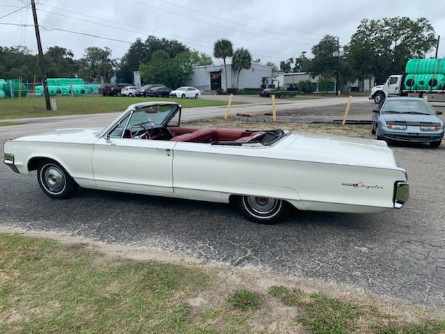

I have a 1965 Newport Convertible, does anyone have a photo of how the back of the rear seat looks with a speaker installed?
I'm planning to install one and was wondering what it should look like. I have the forward facing chrome speaker enclosure and I presently have a board that covers the upper rear of the seat and with a speaker cut out on it. Thanks!

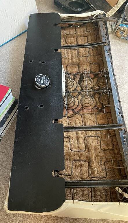

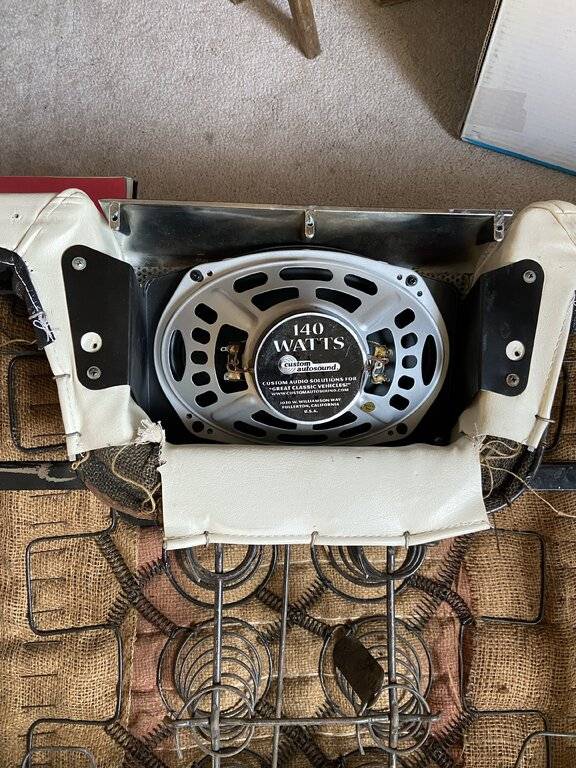

Mine is a 68’ 300 convert and am thinking is the same or similar. There are three pieces: the grill, a speaker mount, the speaker. I made a new cover piece so my speaker hole is smaller.
Looks familiar. Thanks. I was able to locate an exact replacement speaker at Electro- Tech, Inc. So I think I should be OK. I'm hoping to cover the hole so you don't see it. We'll see after I put the speaker in. Thanks again.

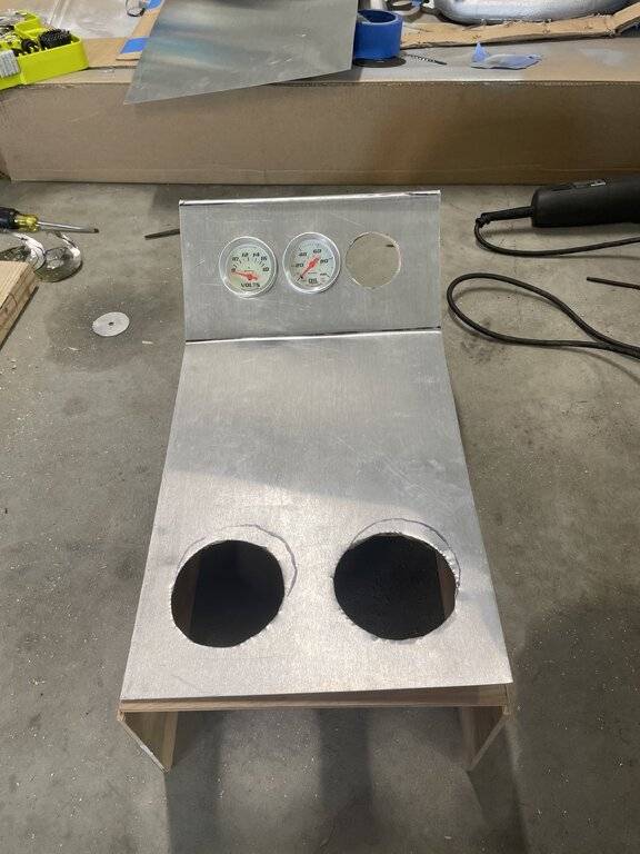

I want put in an aftermarket one down the rd I was gonna mount it above the cup holders! Just was wondering where to put speakers!
