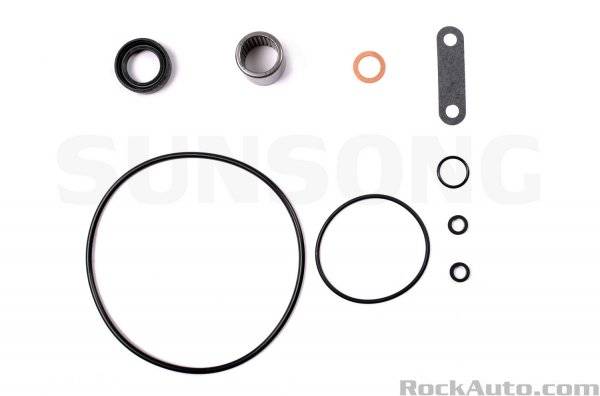

Kit is cheap, pretty easy to do. .
1965 CHRYSLER NEWPORT 6.7L 413cid V8 Power Steering Pump Seal Kit | RockAuto

Omni
There is a large O-ring that sits between the pump body and the fluid reservoir "can." You can go to RockAuto and buy a very inexpensive seal kit that contains all the pump seals, including the big O-ring can seal. It is pretty easy to remove your pump and detach the can and replace the seal. BTW you should also purchase one of these power steering belt adjustment tools from Bob Merritt at Simplex: Chrysler Power Steering Bracket Adjuster Tool Here is a video that is very helpful:
