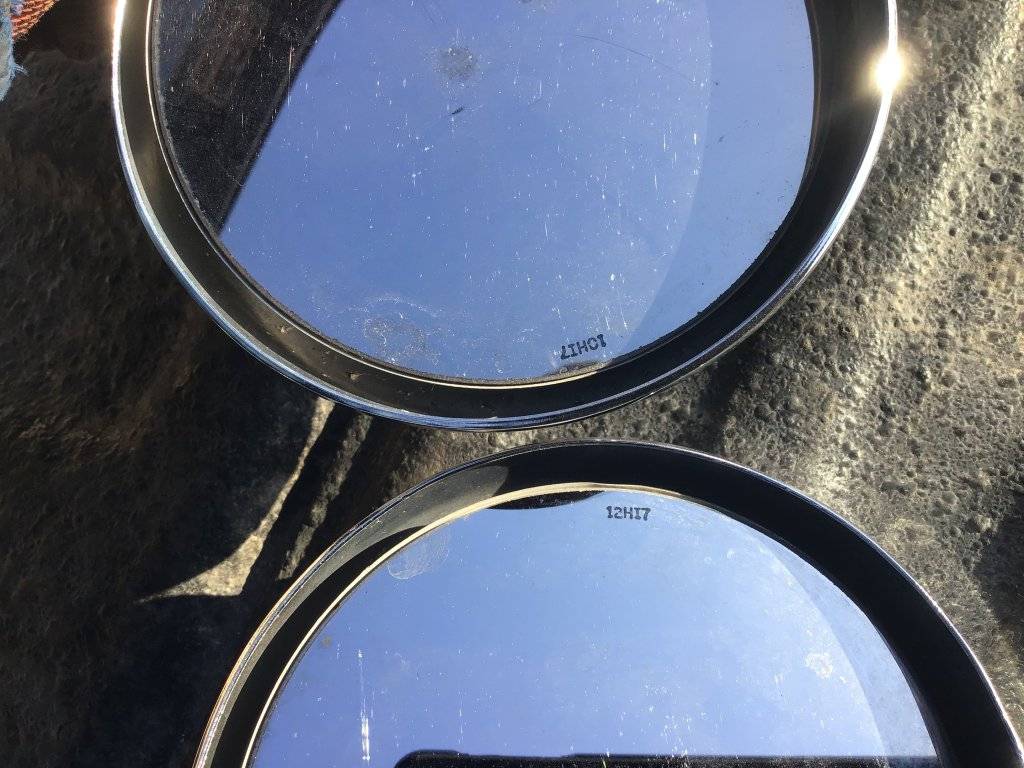

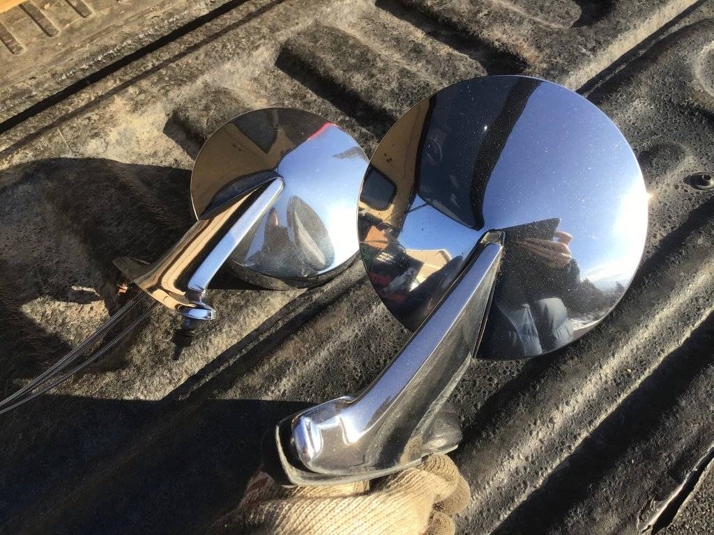

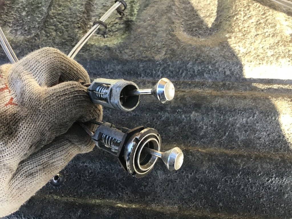

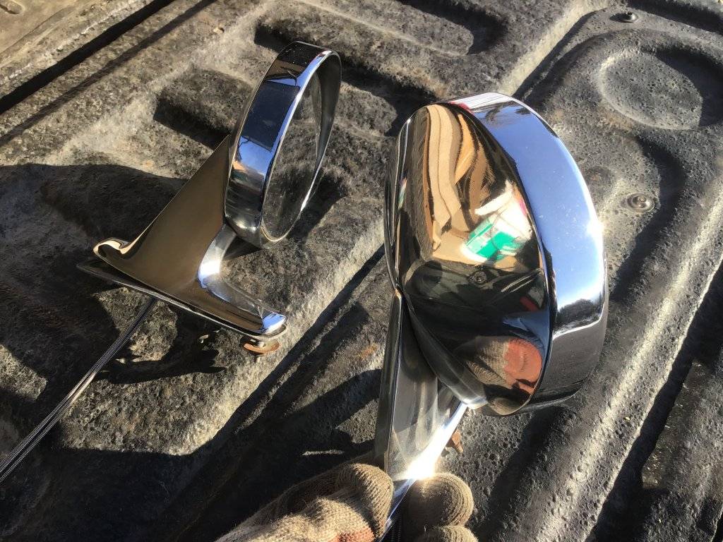

Need some help to ID this matched pair right and left remote door mirrors with a long cable on the right side mittor.
part number on the base is 3796586 on passenger side, 3796674 on drivers side.
There are 3 mounting studs on each mirror. The codes on the glass 10HI7 and 12HI7. Can see in the photos. Thanks for your help.
they arent C body, and since there is a right remote mirror i am going to say they are aspen/volare or 1975 on cordoba/coronet B body mirrors
I had thought the circular style was 1970 and earlier. I still may have a matching left side remote mirror to what you have. I need to check casting number. That's why I followed.
the circular style was used on 69 & 70 c bodies, but there was no right remote mirror available. in 71 c bodies got the rectangular mirrors but still no remote right hand mirror.

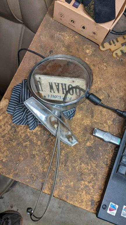

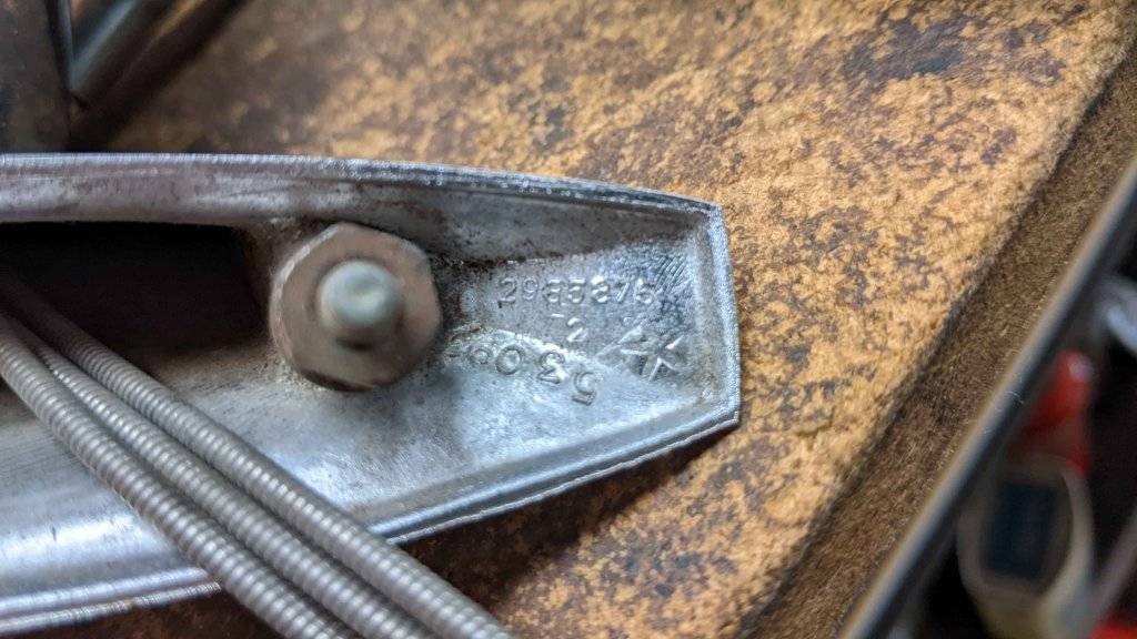

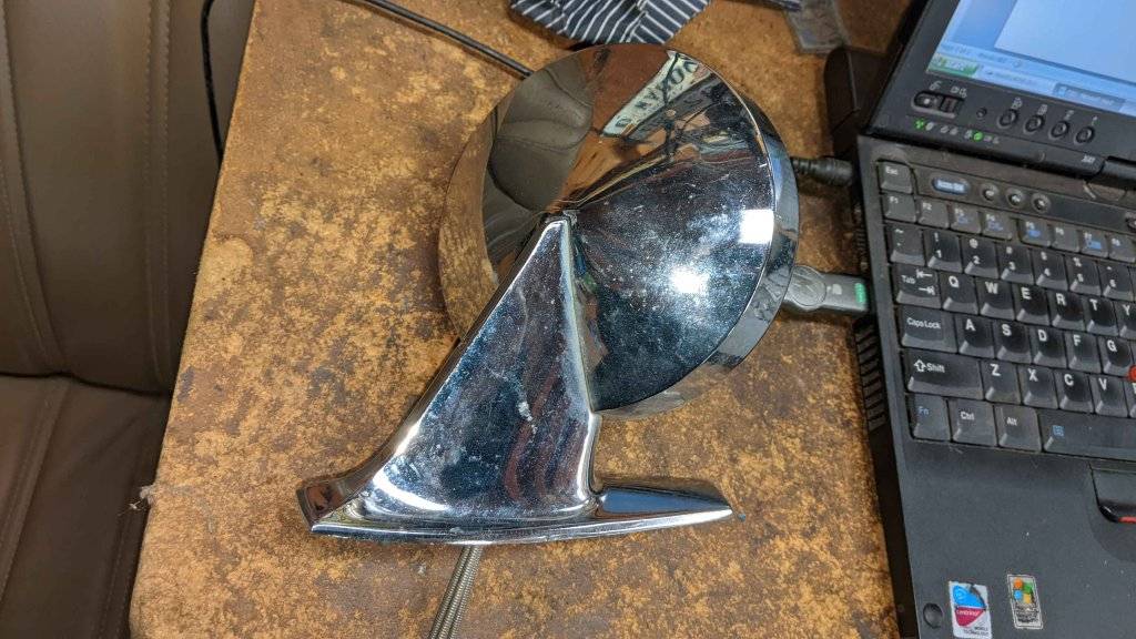

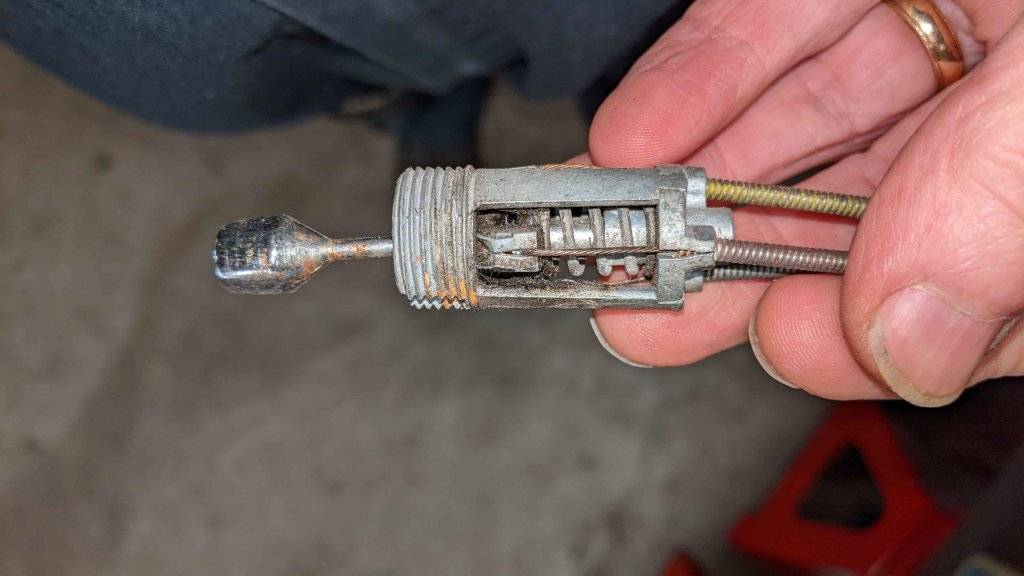

@marko Correction. This is what I have. Not the same. I had a 69 Monaco, but I can't swear to mirror's origin, much less how I got it.:lol:Ben
2935875 per eBay 1969-1970 Chrysler 300 & Dodge Polara/Monaco full size, LHS
