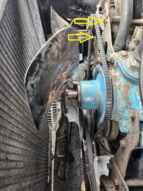

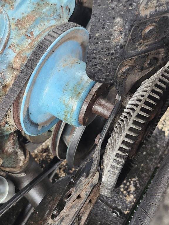

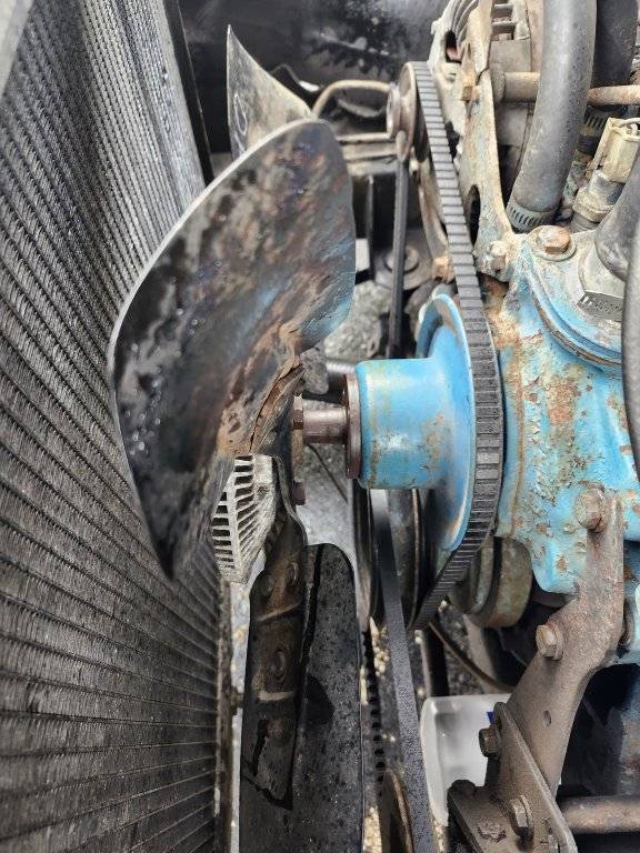

So again with looking at my pics..only the small brown piece with the 4 bolts is all I need to do to remove the fan. Not the blue crank with the belts..sorry trying to explain in my language lol

What he's trying to tell you is if you loosen the fan belt, the pulley will come loose and the fan may come off easier.
Loosen these bolts on the alternator, marked in yellow. Just a turn or two, they don't have to come out. That will take the tension off the belt.
that alternator belt isn't making it tight on the water pump shaft. It needs some persuasion. Pry on it with a prybar. As said above Be careful you don't dent the radiator when it comes loose.
Tap it with a hammer, if you can get one in there. Or, use a large screwdriver as a wedge, tap down on it. There's a "nipple" the fan sits on; makes it snug.

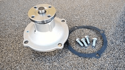

This is what the pump looks like with the fan off. There's a hole in the fan drive that is sticking to the nub on the end of the pump.
