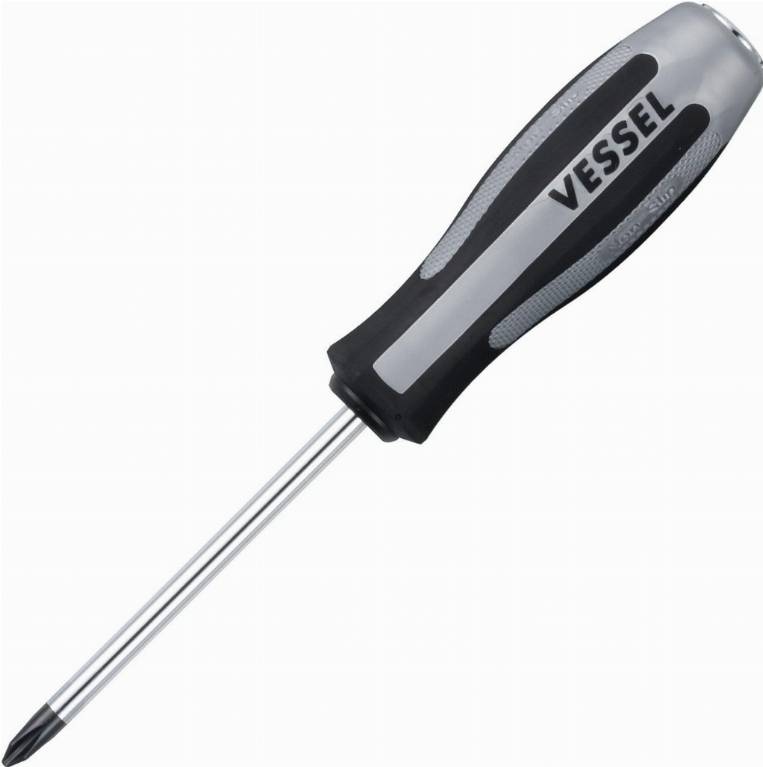

The other is one of these screwdrivers. You hold it against the screw and it rotates when you smack it with a hammer.
Amazon product ASIN B003BI8HHQ
