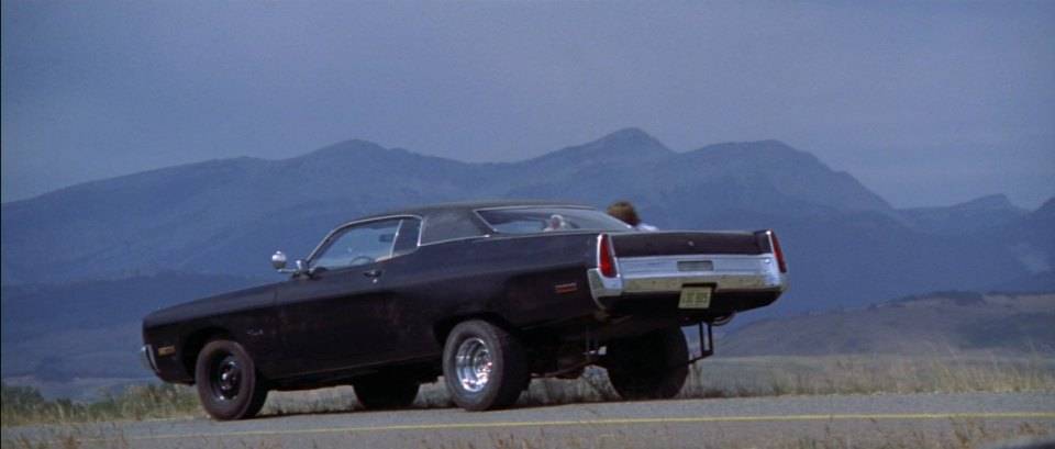

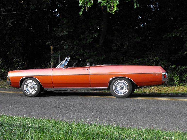

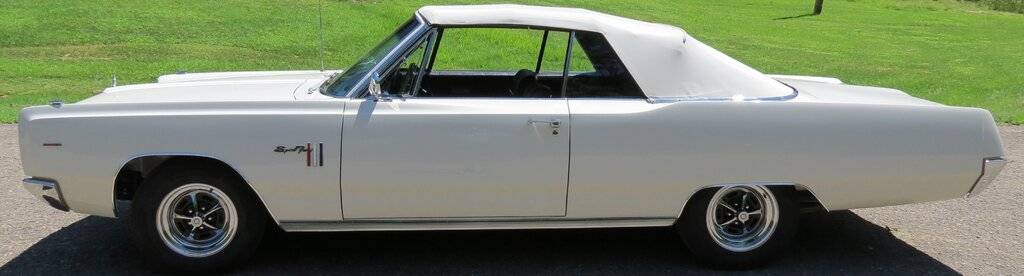

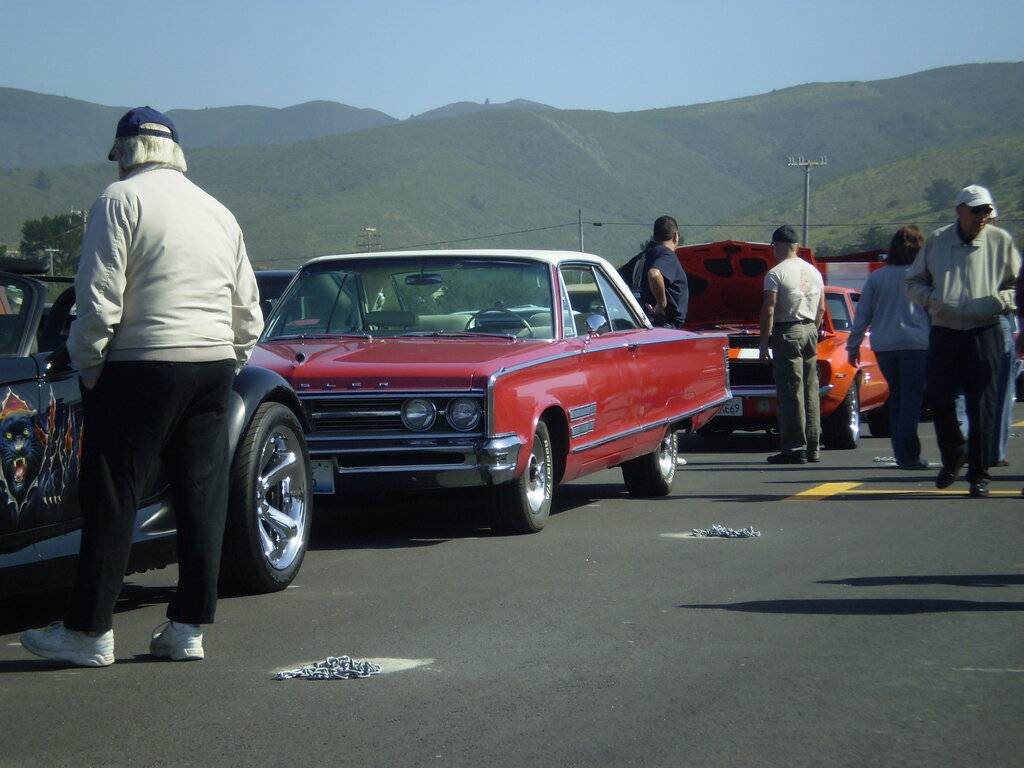

Our Mopars from the factory (Slab, Fusie, Formal) were meant to have a slight rake to them (examples below). Their butts should be a little in the air...about an inch. It's a little harder in the brochure pic but if you put a sheet of paper at the bottom of the tires, you'll see the slight rake.
Unfortunately the standard springs squatted too soon after production and a lot of the cars left the car lot sagging in back.

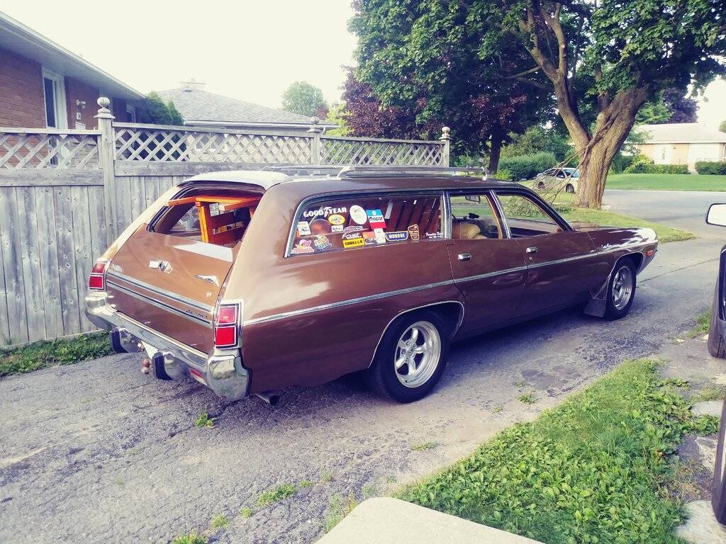

On my wagon,I did use the ESPO srings with 1 inch upgrade..well worth the extra cost..

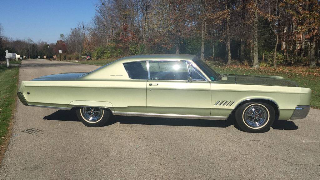

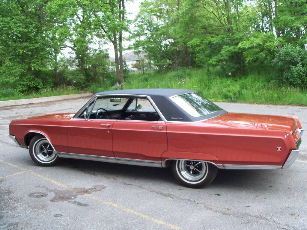

Stance is all a matter of perception in how you see your car sit. Pics are deceiving too! I replaced mine from a small spring company in Chicago, I don't know if there over-lift or not? Different angles give different stance looks as well, this car hadn't moved a inch!!
The stance differences can be attributed to how the sheet metal between the rear wheel and the bumper is shaped. Slabs have a more upward angle as Fusies are more parallel to the roadway (which also helps the rear bumper be blended-in more, with the use of the famous rear valence panels . . . as the chassis attitude remains constant between the two model year groups. I didn't realize this so much until I put the y-pipe back '72 Chrysler single exhaust (OEM bolt on replacement items) on my '67 Newport CE23. Everything fit as it should have, but that rear pipe piece had to get a slight tweak upward for it to be in the normal height location and meet the normal rear pipe hanger height.
