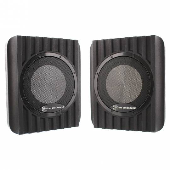

I used these guys to modify the factory AM/8 track radio to a 40 watt 4 channel/ blue tooth / USB.
I then used these under the rear seat .. Undercover II Speakers Pair 250W
Im not impressed as I threw it together off the cuff, shooting from the hip. It certainly isnt like previous Kenwood systems Ive had in my hardtops but its better than nothing on long rides.
