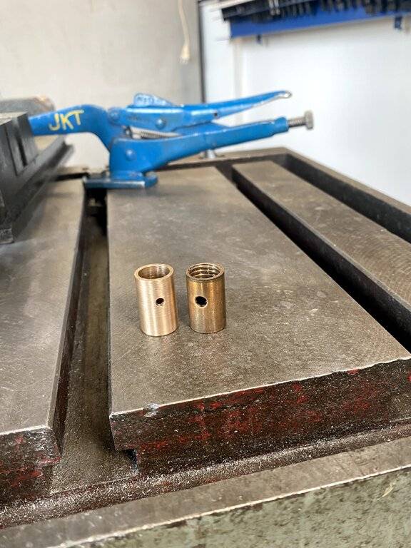

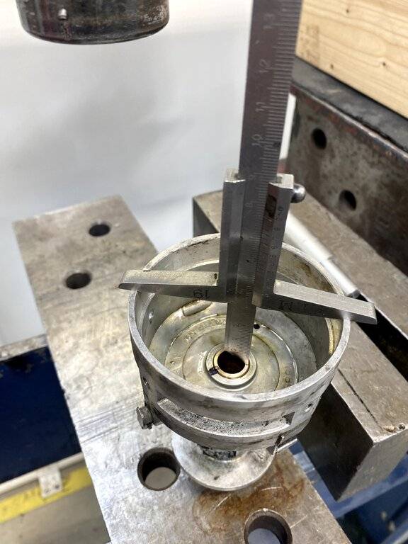

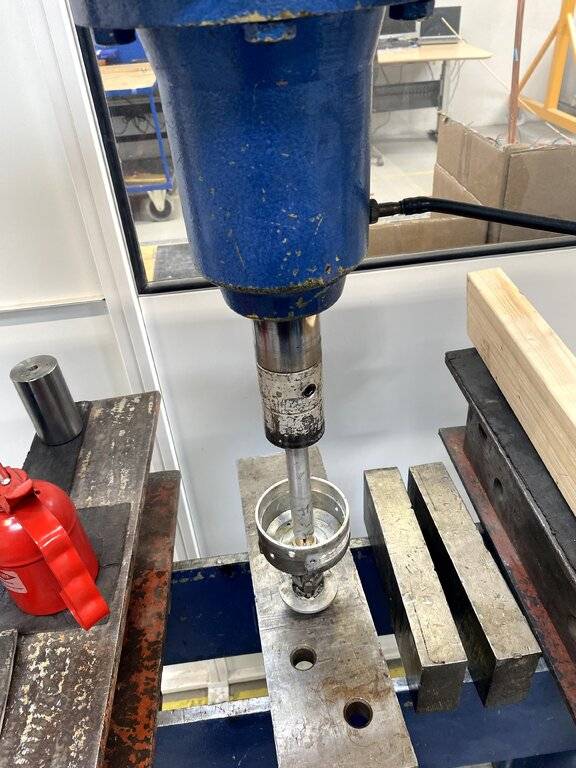

I was probably wrong about why the oil hole in the bushing was misaligned. I used regular bronze in stead of Oilite. And I reamed the bushing in stead of burnishing it in place.

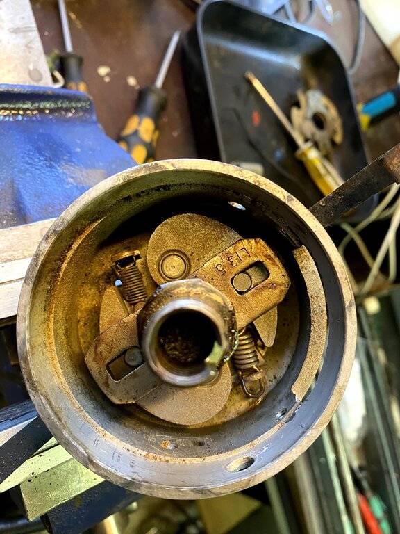

Other than that; the repair worked and I was fortunate to receive good advice from the forum members here.
One things with new bushings they should be burnished which locks them into the housing. I do not think he will have that issue though.
