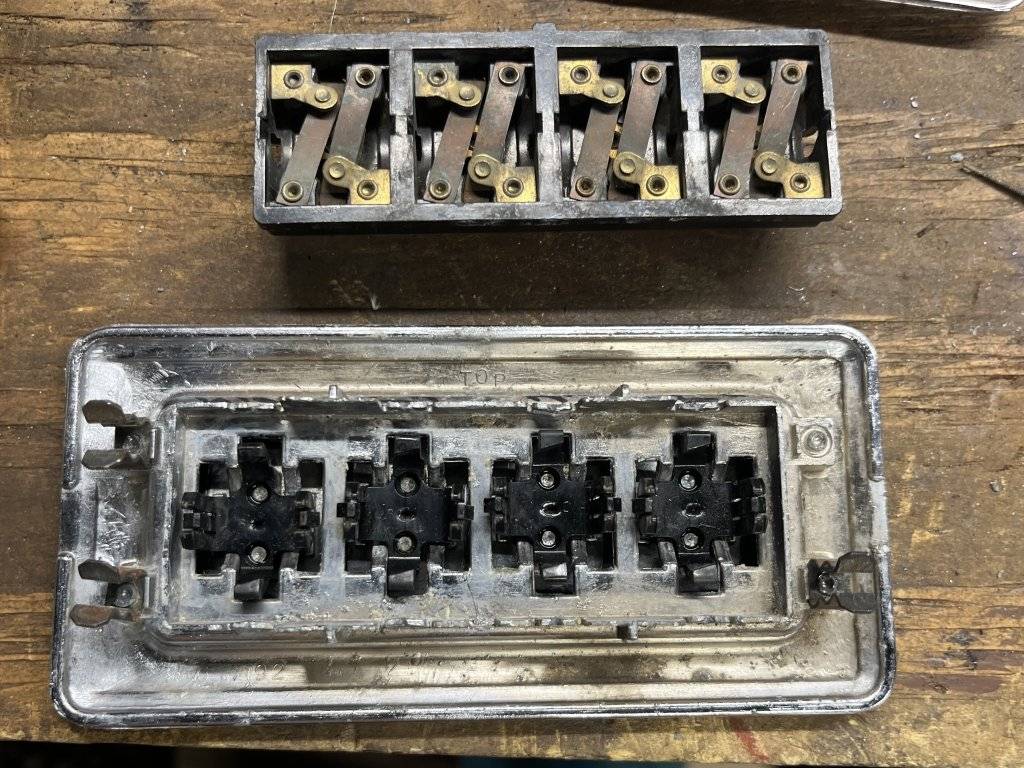

Finishing up a few loose ends before my trip. I had some issues with the rear left quarter window, but with some help here and from my more electrically literate son, I was able to clean the contacts in the master switch and get all the windows to work.

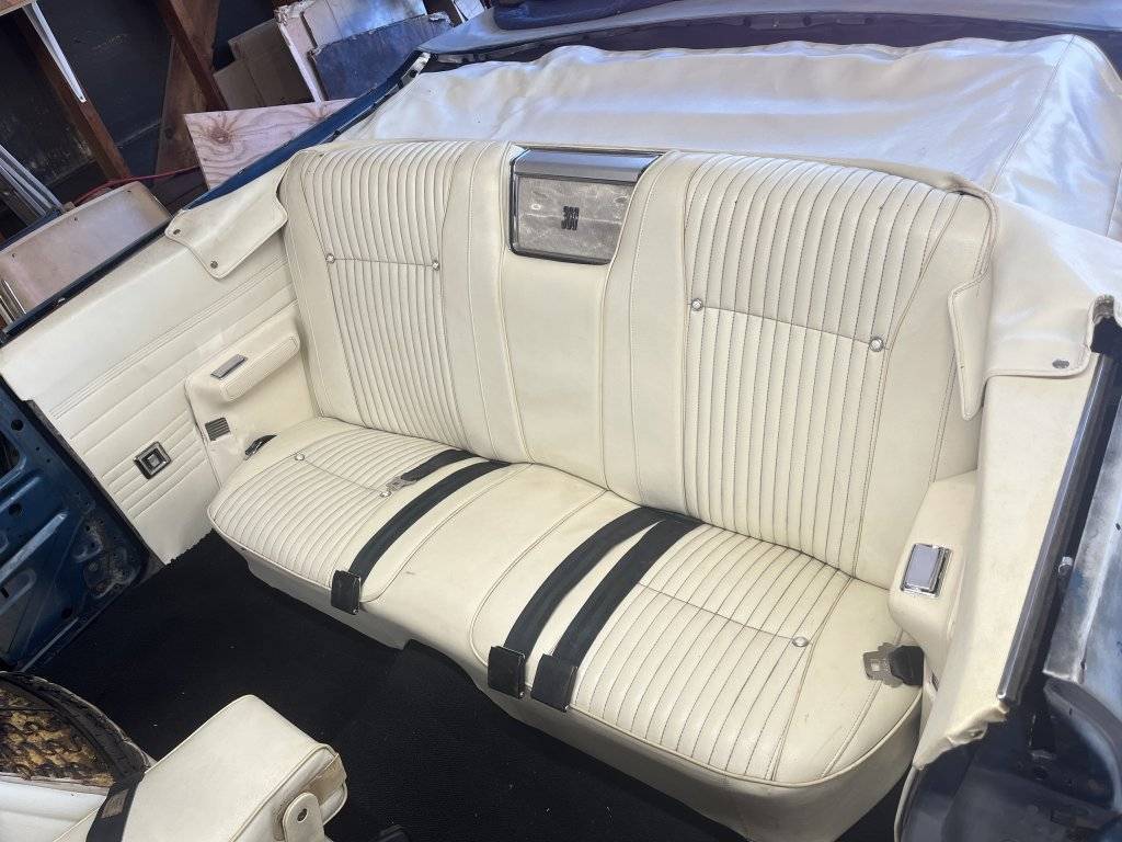

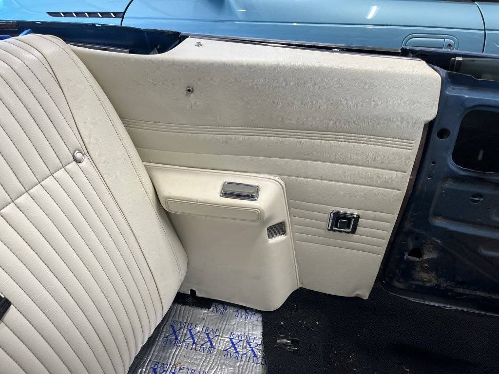

Time to button up the rear door panels and freshen up the rear seat area. Panels and seats are all original materials and cleaned up nicely.

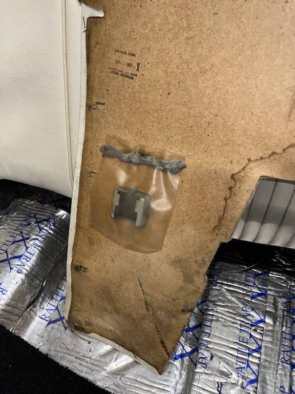

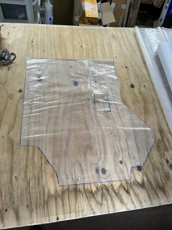

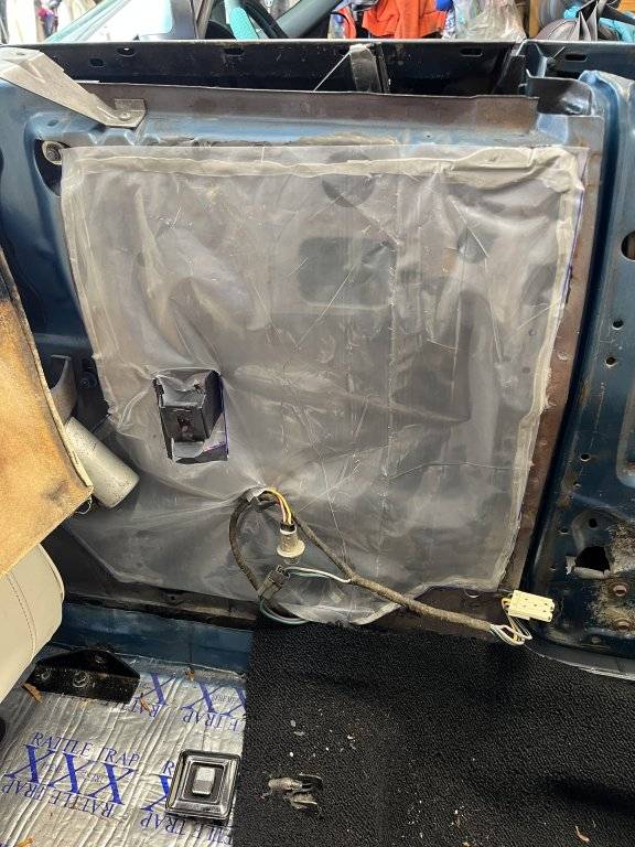

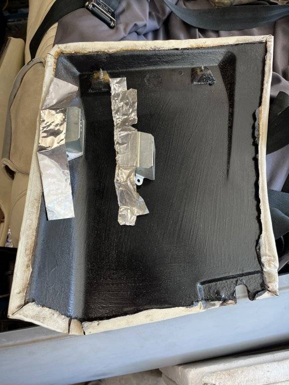

I wanted to reproduce the plastic liner since mine was missing. I have one from the TX9. It is slightly different, but I was able to get a decent pattern from it.

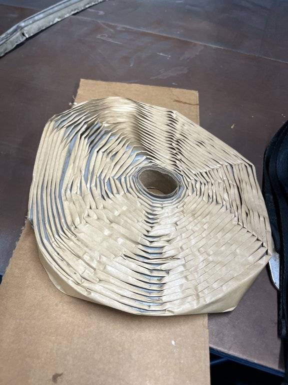

Last year I bought a huge roll of butyl tape, it was less than $20 at the home depot
I was very satisfied with the outcome.
When I got the rear armrests, there was silver metal tape around the courtesy light. I’m not sure if that was factory and decided to replace it with new tape.
Very satisfied with the results now that the back seat area is complete.
