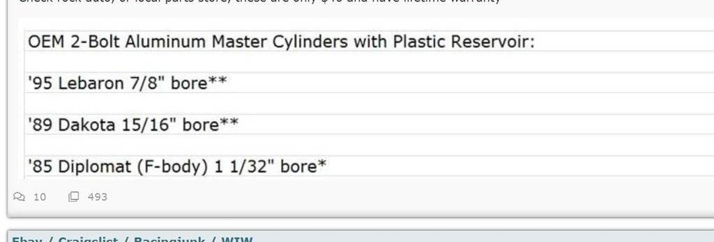

Late 80s into the 90s aluminum master cylinder from a pickup truck or van will work. You need a adapter 4 bolt to 2 bolt and you may need to add something to pushrod to compensate for adapter. Only buy new aluminum master cylinders, it's hard enough to get a good cast iron reman let alone aluminum. There is no advantage other than weight, which on a power brake C body is about nill.

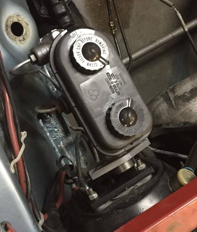

Oh Master War Lock, Pray tell this minion the model number(s) of your cache? Thank you!
On some of the performance Mopars I have used the aluminum two bolt masters with adaptor to booster or no booster. The later 2 bolt master cylinders are what I would call a male base so the adapter does not cause an issue with push rod. You will need to check for proper adjustment of pushrod like you should do with any master swap. Richard Ehrenburg was selling aluminum master kits with adaptors.
Thank you, Boydsdodge.. E-Booger, eh? Ebayer still? I'll check.
