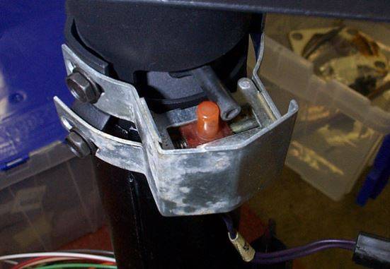

If this is a 68 with column shift, make sure the plastic pin that rotates as the gear lever is moved is still there. When it rotates, it slides the mating part on the switch to trigger the lights. This all happens way down the column towards the firewall. My 300's is gone and is the only thing keeping my rev lights from working correctly. NOS ones aren't priced very nicely...
Pics attached of some I found online last year.

Thank You I apologize for the late response I had a funeral to attend that is the exact piece my car is missing. Quite A mystery I always had reverse lights till I got it back from the body shop. Hopefully I will be able to locate one Thanks again Frank
Pat
T was able to purchase one on E bay out of curiosity how hard is that to install
