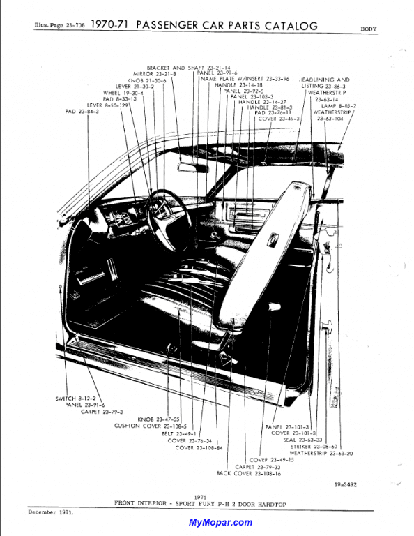

Need to sort out the right P/N for some 71 fury door pulls...Big John was kind enough to provide Nos door pulls for my 71 gt and now need to round up a pair to replace the set John was kind enough to provide...bought one set but were wrong ones...anyway if anyone has the correct P/N handy would be gratefull...thanx

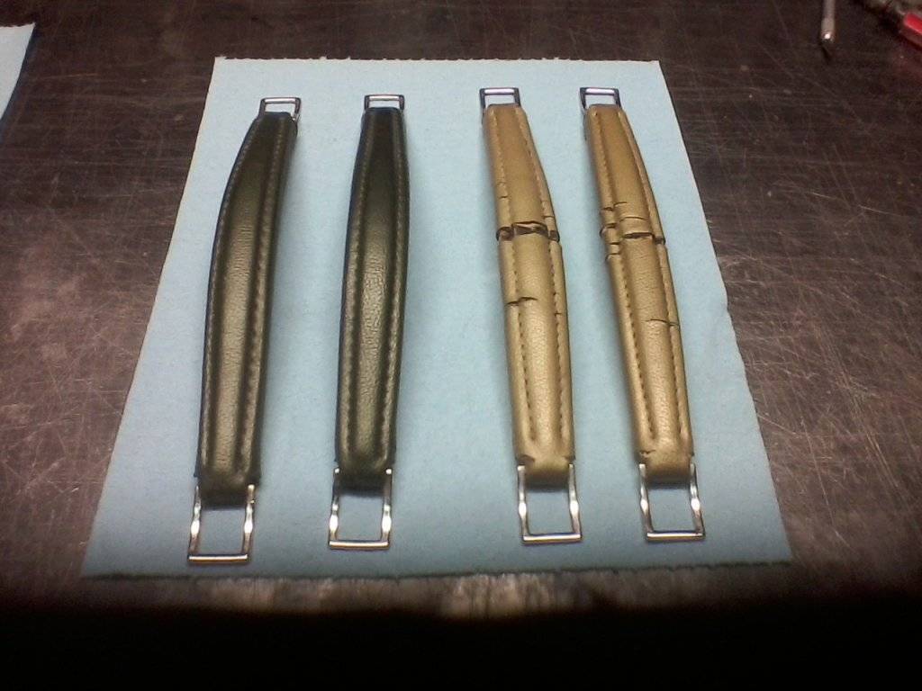

The original pulls were made of a metal band with strips of layered cardboard in the center and encapsulated with vinyl and stitched. Really crappy, cheap method. Solid vinyl with a metal band in the middle supplanted the first version and was used in later production 1971 C body models rather than the initial version, but they never looked quite a good to me as the initial version. The new design was used in all the 72 and 73 C bodies with them and generally held up well.
