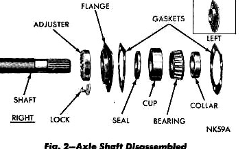

Second test drive. Front wheels were 150F, back left 105F, back right 220F. I jacked up the the rear right and I could move it, but it was definitely restricted.
I won't be able to work on it unless I get a rainy day this week. Thanks for the info now I have items to test, and take care of my axle play too.
