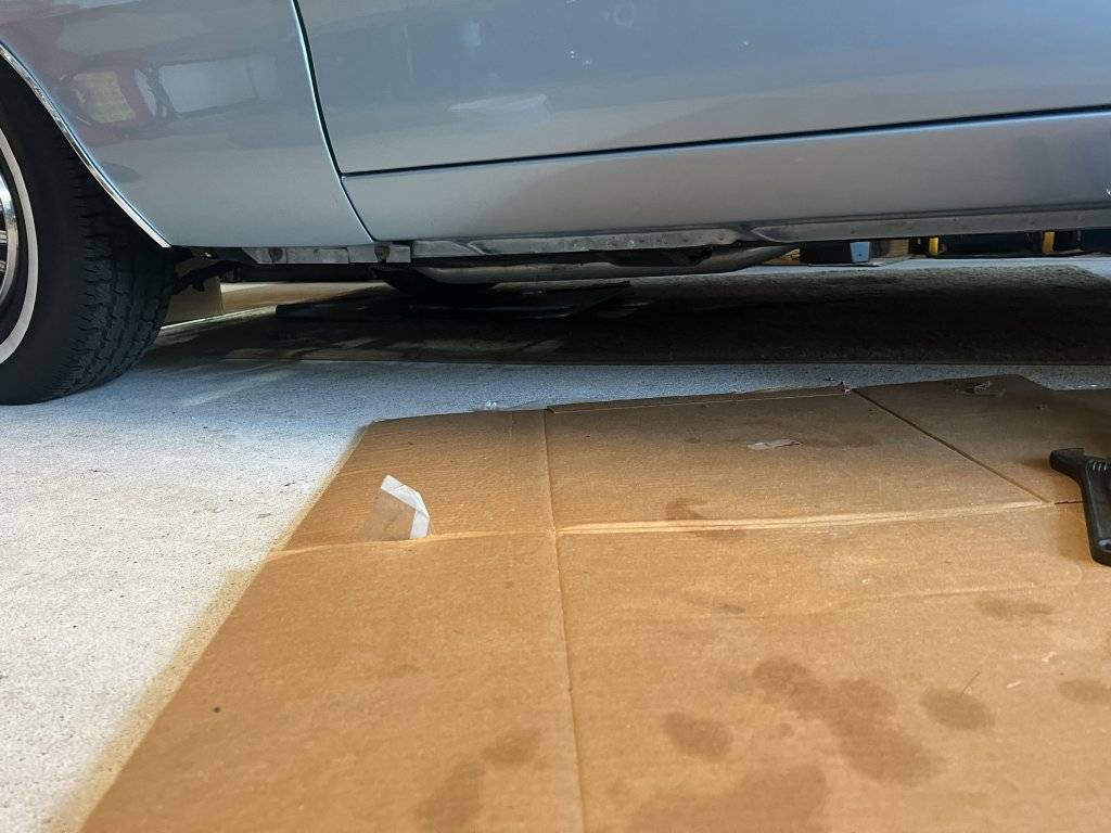

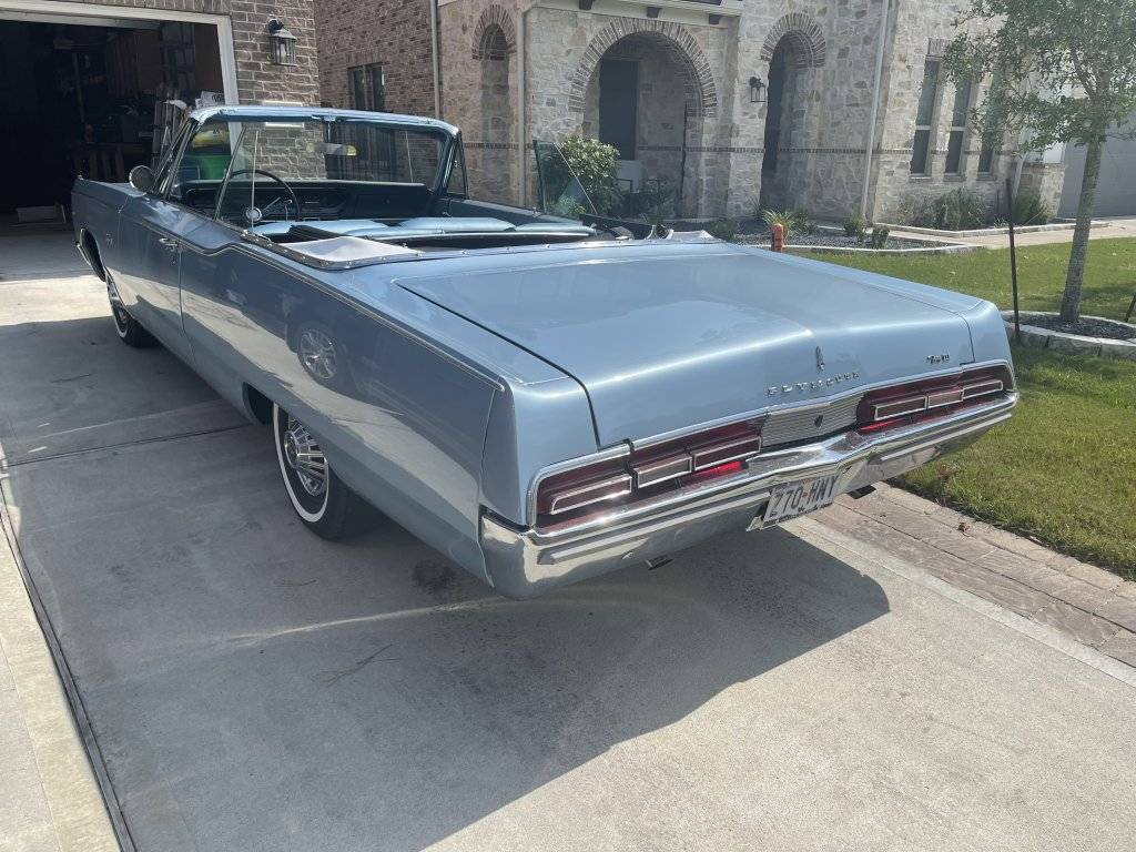

heya folks... i was looking at my car from the side and thought something was amiss with the way the side/bottom of the car looked. Thats when i looked at some older pictures and realized I am missing a couple pieces of trim. i believe these trim pieces are referred to as "rocker trim" or something along those lines? In any event, i have googled and googled for the better part of a few hours now - lost in an internet hole. I cannot find these things. I believe there may not be any for sale. That being said, do people make any aftermarket pieces of trim? i cannot believe there is much of a demand for these things.
The car is a 67 plymouth fury 3 (convertible if it matters). I have a bad picture of the side below. this aluminum trim would run along the base/bottom of the car from tire to tire.

i think you may be right. in the attached photo there is a portion of the frame that is visible that i feel should not be. However, if you look at the photo you provided above i think it may be visible there too BUT the shadow is hiding it. im going to leave it alone. it is a little unsightly but i guess that is just how it was made. thank you for the photo though.
the trim does NOT cover the pinch weld at the bottom of the rocker or the bottom edge where the fender bolts on...what you have there is normal...look how much money you just saved....the problem is that the car is too clean and shiny down there
The fact that the pinchweld areas are body color is indicative of the fact the car has been repainted. In production, those areas were covered, somewhat haphazzardly (brush or speray gun), with satin black paint to hide them better. So,careful application of some satin black spray enamel would work well to hide that area better.

ahhhh snap... you guys are right. I should "carefully" take some flat black, or maybe even an undercarriage paint, to the shiny blue down there.
