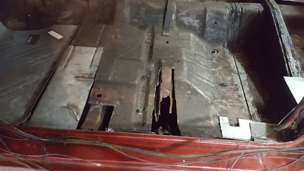

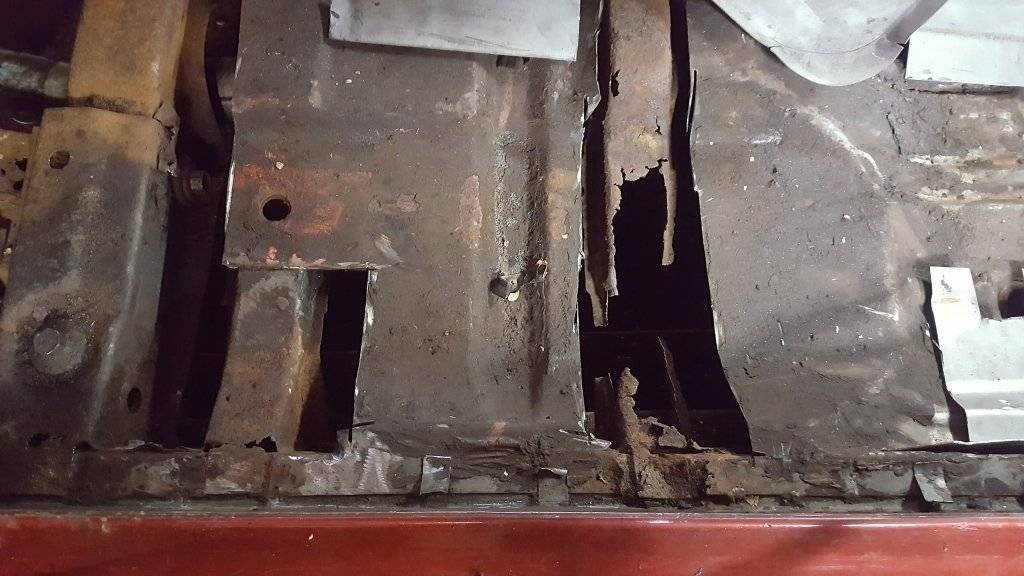

Hi C Body Fans,
I'm working on restoring a 67 Plymouth Sport Fury and I've hit a bit of a stumbling block. I've discovered my floor pan support frames (I think that's what they are called) are rotten and I'm trying to determine the best way to rebuild them. I'm wondering if there is anything I can purchase to replace them or whether I need to find a shop to custom build.
Thanks for the help!
Ryan
This is a hard one to call without pictures from the underside of the car. The one area looks like the stub frame to me, and if it is, you would be better off with another one.
if the other side is okay , you can use that for your paper dolls from card stock like matl' , i like to make a card house in the shape to transfer on to sheet metal stock to cut out and fit , just like building a model airplane from scratch . not the folded paper ones , lol .
I know someone in Ontario that has these for a 73 Newport. check the parts manuals to see if they will work!
PM me for info :)
