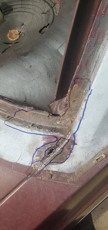

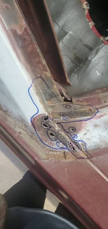

hey yall! I have some "pinhole" rust spots at the seam where the lower c pilar meets the truck deck on my car. dont know exactly how to describe the location but its on both sides, the driver side had a bunch of rust scales on it and i wire wheeled them off, revealed about 12-15 little holes and the passenger side has like 3-5 holes. pics tomorrow...
my question is how do i fix this? i was thinking of just welding a peice of sheet metal behind it but its in the bottom corners of the metal where the rear window seam is too, so im not too sure. id fill it in with weld if my welding experience hadnt taught me how easy it is to blow out an old rusty hole.
thanks! -Paul
i highlited the area i was trying to describe if that helps. its infected that seam there. im not about to cut the entire back of the panel off to fix a minor spot, again was thingking sheet metal under and spread some bondo over, or maybe i could even get away with just spreading bondo over it... thoughts or better ideas?
-paul
-paul
Personally, I would choose to do the repair correctly but if you are going to do what you are describing, I would forget the bondo, clean out any rust scale or pinholes until clean metal is achieved, put in a piece of patch metal on the underside of the panel using JB Weld to secure it in place and then use JB Weld to cover the holes on the top side. Bondo absorbs moisture and will generally not be a stable surface to remain flat when paint touch up is applied (if, for example, the underside is not completely sealed from moisture and it penetrates the underside patched area - I had this happen to a car that had been repaired as described with bondo and the underside over time absorbed the moisture and the top area bulged upward). JB Weld will secure the support panel (you definitely do not want to weld in that area with the window in place and for other reasons). Then seal the whole top area against any moisture with JB Weld as well and you can also sand it down to make a surface that is nice and flat and then prime it and paint it. Such a repair would likely last the remaining life of the vehicle just fine.

the window is out right now as i am in the process of replacing the seal. figured id adess the rust whit eit was out as it would make it alot easier. i wire brushed it all down to bare metal. i know i should probably cut it out and replace it but im not skilled enough to repair that seam, and the vynil top is going to cover it.
i like the jb weld idea, i dunno why i didnt think of that. i havent had the greatest experiances with it on my f100, but then again i was 15 then, im coming on 18 now...

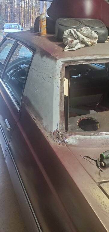

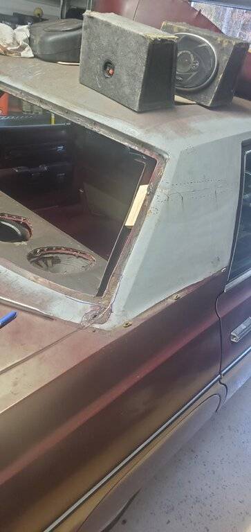

This was a excellent write up. I am including some pictures. I was wrong... the entire fix will be covered with a vynil top.
Although late to the conversation I 100% agree w/ Big John, unless you cut out the rust It will come back bigger and worst than it was before. the lower channel in the back glass is notorious for rust out. The rear class reveal trim traps fine dirt there and trap moisture. Left unattended rust areas develop. the same will happen at the inside bottom of the doors or deck lids
