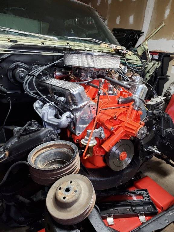

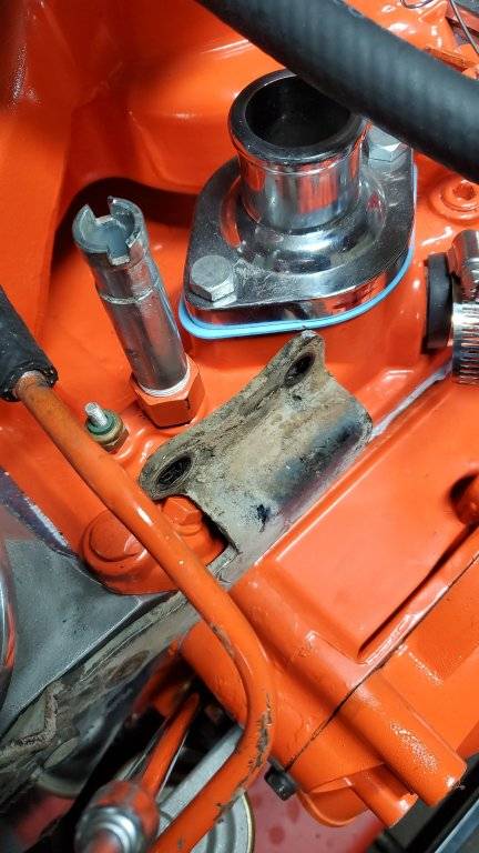

I've got a 68 plymouth fury done a 318 to 360 swap now trying to swap from a rv2 a/c compressor to a sanden type. What compressor and brackets is everyone using to do this? Didnt notice how most aftermarket intake manifolds will not work with orignal chryslers compressor with the heater hose coming from the front of the motor. I already put a aftermarket intake manifold on the 360. Can't find anything UPDATED on the subject lot of the old forms links don't work anymore. Any pictures or help would be appreciated of any belt orientations for these small blocks with a/c the 360 didn't have any pulleys when I got it and none of the pulleys off the 318 line up with the 360 because of the iron to aluminum water pump. I also have edlbrock heads so it offsets the alternator.
