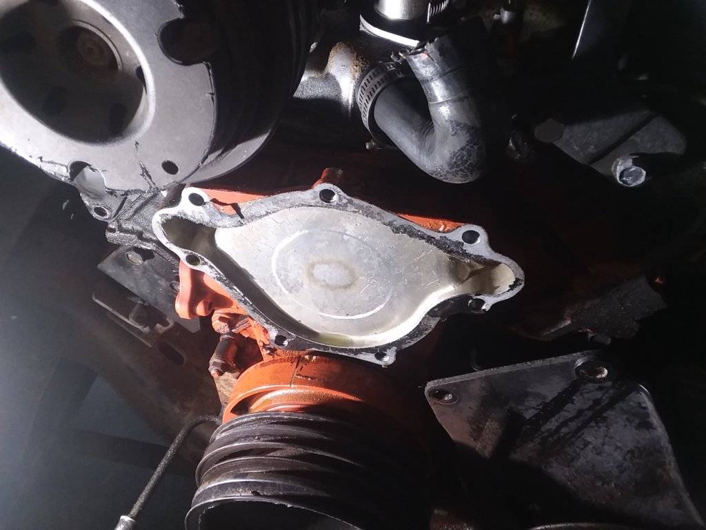

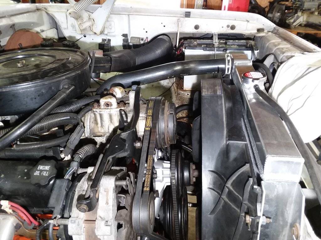

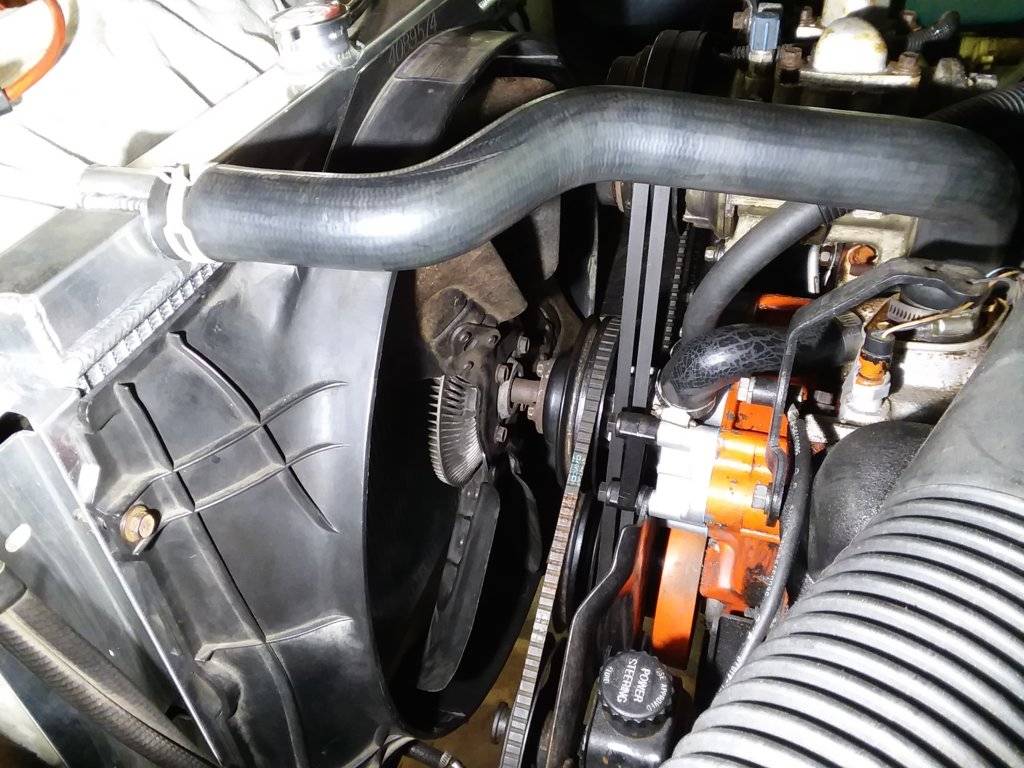

For all the small block V8 guys 1970 and later, this happened on my 1990 360V8 truck, but it could just as easily happen in one of our cars (same water pump). I was driving home from work and suddenly heard a loud screeching noise that varied with engine speed. I stopped at a gas station, looked under the hood, and oil and gunk was spraying from the front of my water pump. I shut the car down. I grabbed the fan and was able to move it forward and backward by hand, but it wasn't hitting anything. I thought: bad bearing couldn't possibly make that much noise.

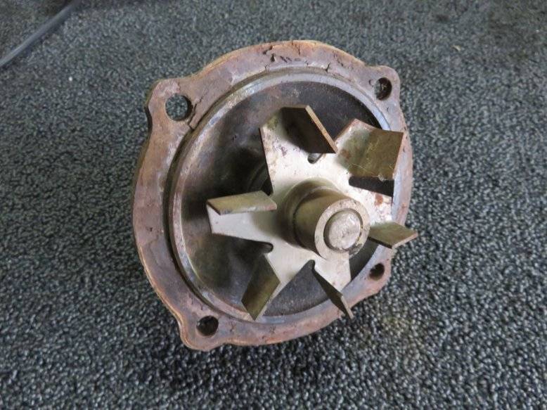

But a propeller hitting the timing chain cover/wp housing and water pump can

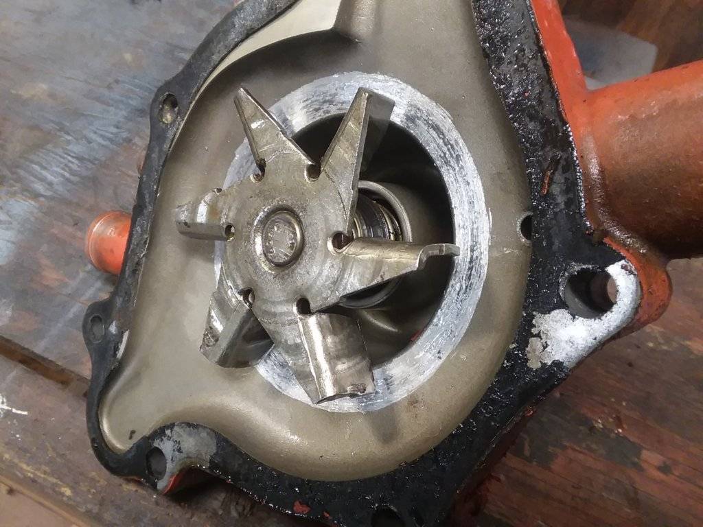

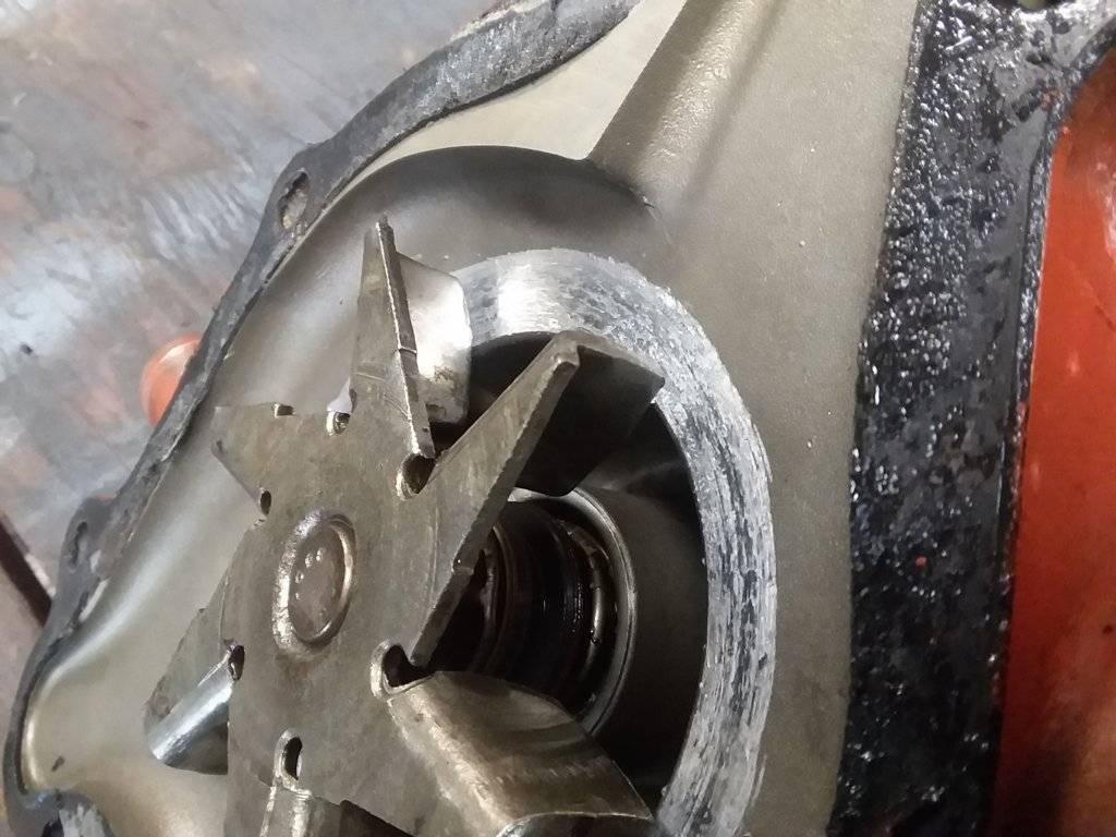

From the pics above and below, you can see the exposed spring end
My question is: What normally keeps this spring compressed? Is there something like a valve spring retainer and keeper? I found no loose metal parts or pieces when I removed the pump. Thanks, Ben

Pretty sure these were an all pressed fit, I think from what I can see in the photo that the inner bearing disintegrated and left the seal compression spring exposed. You might check the FSM to see if there is an exploded view of the water pump to see if there was a snap ring or other retainer, I do not think that there was. Probably would be a good idea to run a magnet inside the timing cover ports to see if there are any loose parts in there.

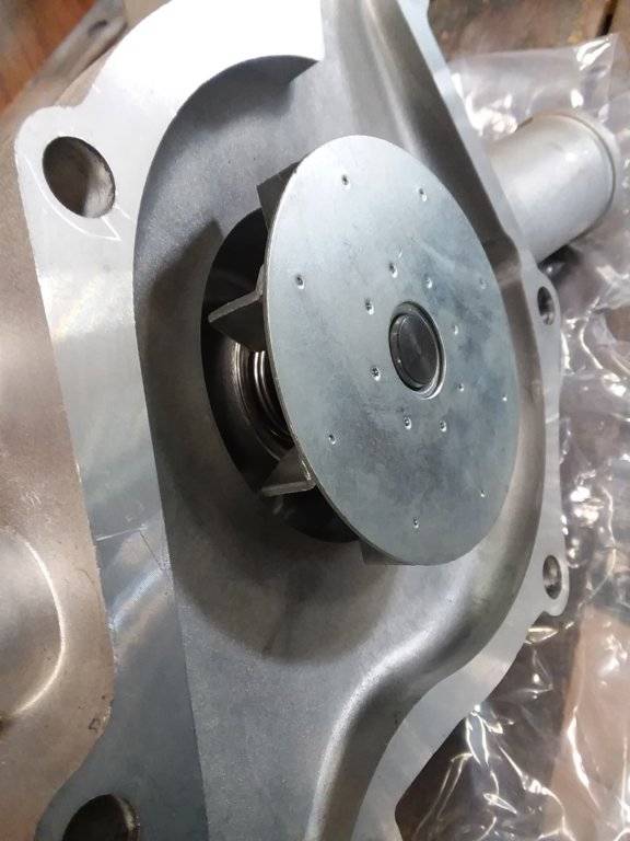

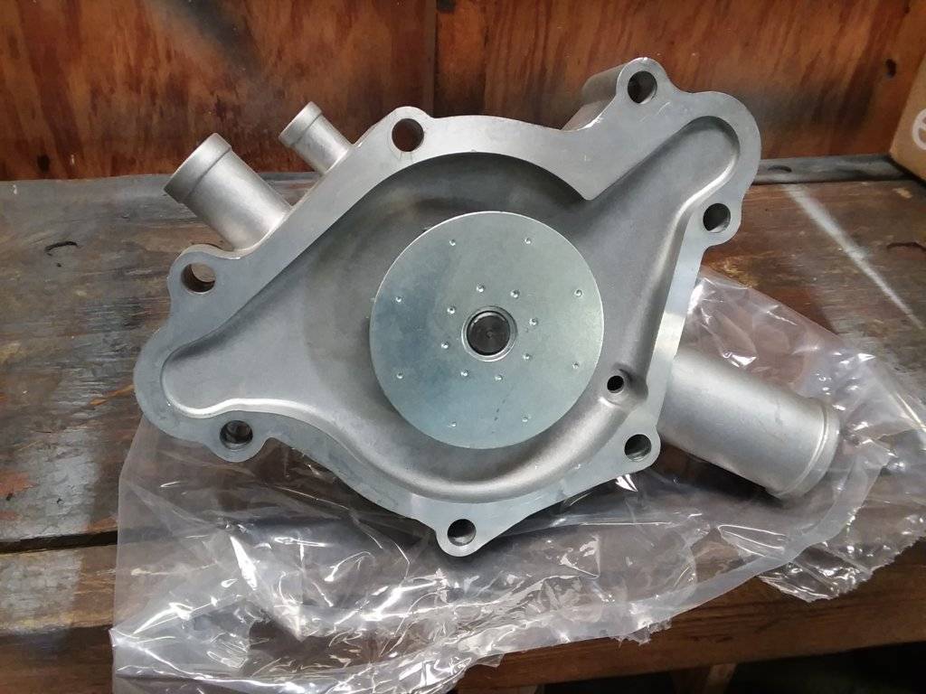

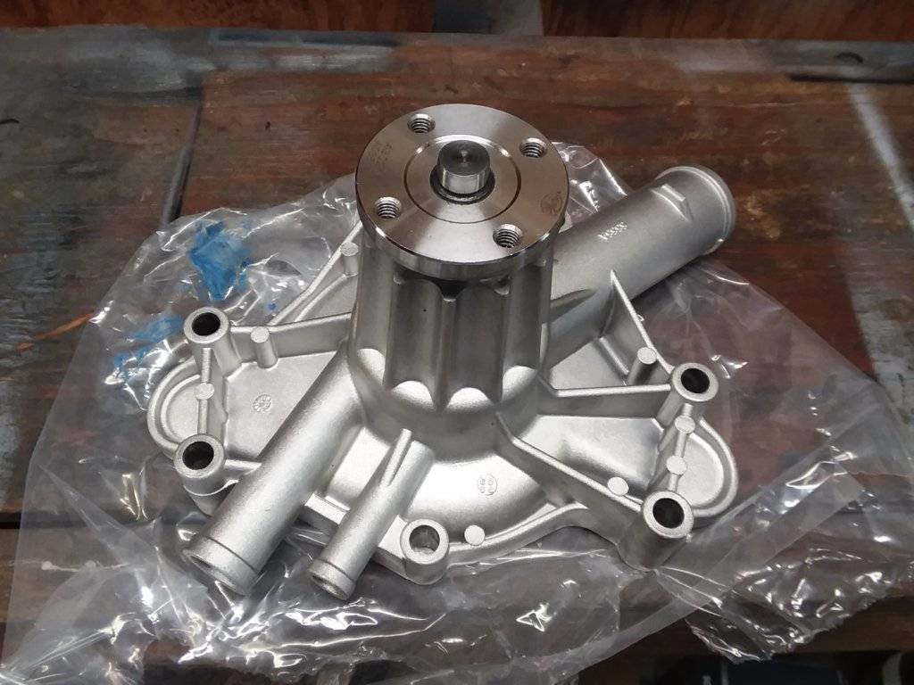

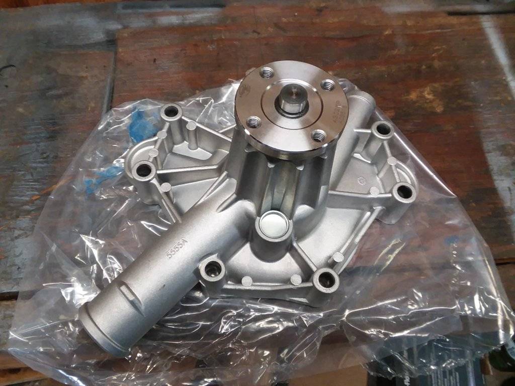

Here is the HD NAPA water pump I used, $106.99 but I got 15% off. Really smooth and tight when turn impeller.
Seems you can see spring end exposed so that must not mean anything. It must be that the press fit wore out and the components became loose.

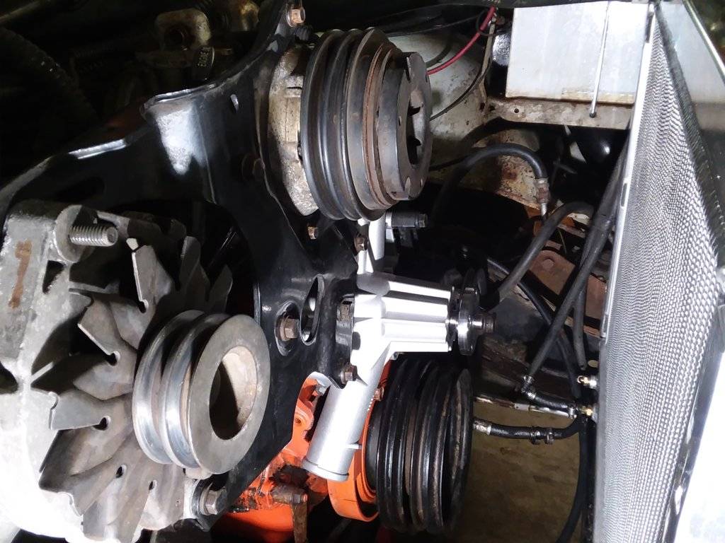

Installed
Doesn't leak a drop. Gasket comes with. Looks like Felpro 6584. Permatex #2 on threads of lower 4 bolts. Install all 7 bolts at 30'lbs per FSM.
