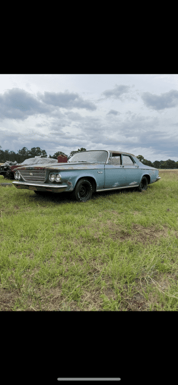

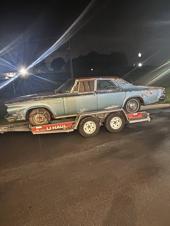

Yes. I paid $1500 for it with a locked motor and 3 speed on the floor. So- I’m not buying top shelf stuff for a four door beater.
I did successfully get the motor unstuck, established spark, and she fired right up. I’ve replaced the brake master, fuel pump, oil change with zinc additive, and now this water pump w/ new thermostat.
