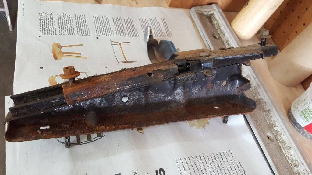

My front seat tracks (1970) are not designed to be easily disassembled. They are full of dirt and old grease. The local machine shop has a "tank" that they use to remove grease from parts. Are there any plastic parts inside of the tracks? From what I can see, they are all metal and it should be safe to use the tank.
Assuming I can get these cleaned up, is white lithium grease good to use for lubrication on these?
Thx.

Thank you. Do you think bearing grease is better? I have both.
id strip em, POR15 em, and put em back in.
I'm not sure about which kind of grease, but what I was thinking is some grease that will not get runny in high summer temps... i know you are not here, but down here our car interiors get 140* ish during the summer...
I blasted the rusted areas, used some brake clean on the tracks till the slid freely (sand out), painted them, greased them up and installed them.

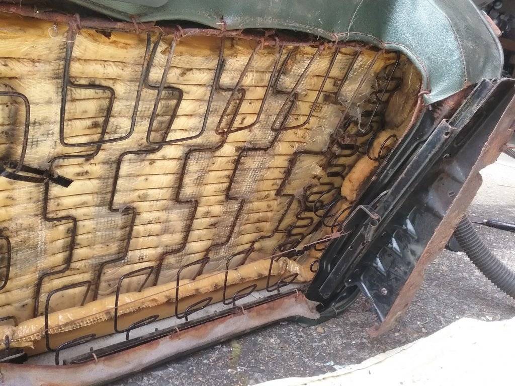

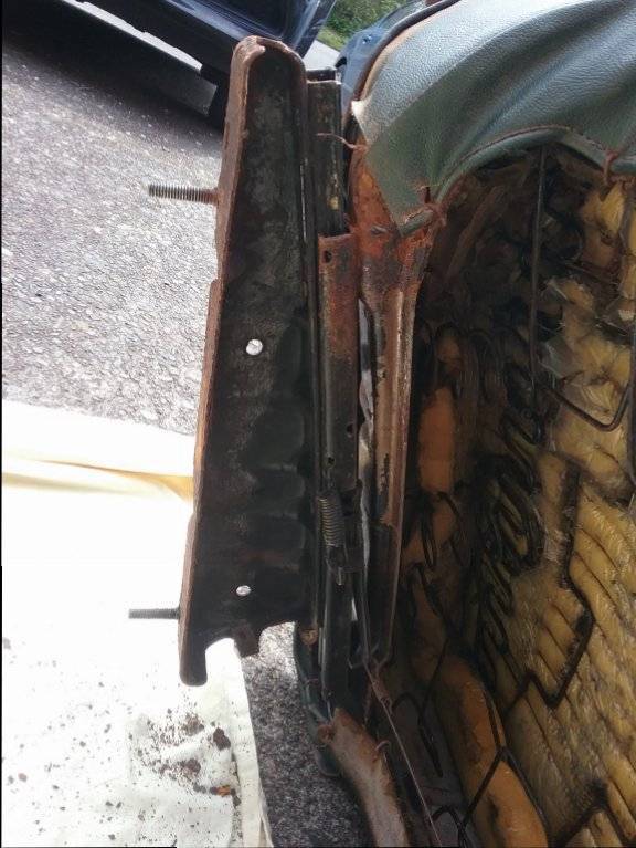

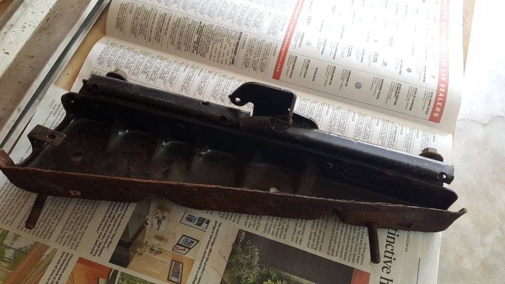

Did you take some pics? I have some seat tracks that i suspect might be C brackets and would like to compare
I did but my server is offline right now.
Alan
Thanks Alan. I have some that look like the pic you did post but would like to see more pics to properly compare. It's a bench seat right?
p.s. I'd like to see the pics anyway just to see them all nice and done :)
