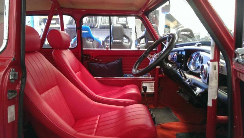

While I like this, it would just look out of place in an otherwise fairly normal car due to the large shoulder support:
so again, has anyone ever done something like this to improve a stock interior in a car not trimmed for racing? and has pics of it? I used to have full race buckets with a 4 Point harness in my Mini Cooper and loved the "feel" when driving, but this combination is not daily driver friendly and you have to watch what you eat so your *** dosent become too fat for them. Also, the Fury is not a gocart like the Mini was and that makes a big difference too...

those are the cobra classic RS and I think they would look nice. As you see, more for british cars tho
