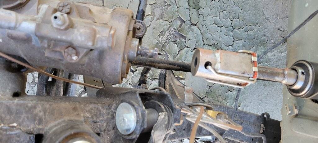

Good morning, I have an issue I'm trying to troubleshoot, and if I can avoid the solution being welding it, that is what I'm hoping to find. I am converting my 68 T&C to buckets and had a console steering column from a 68 sport fury. I rebuilt it last spring and after mocking it up, found the rag joint is a good 3 inches short from hooking up with the ps box. I can't extend the shaft (original wagon column must have been longer and also had the collapsible shaft) but my assumption was the c body shaft had to be interchangeable. Is there a way to bridge the gap with a coupler? Are these on the aftermarket to stretch the end of the shaft or rag if needed to get out to the box, or attach to the box to extend out to the rag joint?
