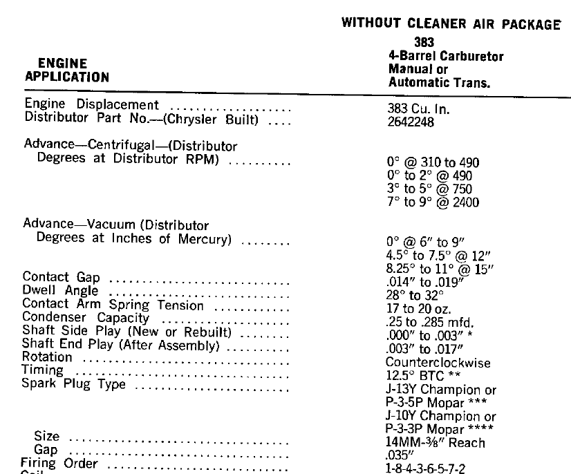

The '72 400 2bbl had J-13Ys rather than the prior J-14Ys of the '66 Newport 383 2bbl. Almost all of the old 383 4bbls spec'd J-12Y or J-10Ys. To me, the 10s should be too cold for normal driving, but they had to tolerate long police chase situations, too. So "cold" it was. Even some J-9Ys in the earlier 1960s, IIRC.
From my experiences, "creeping heat" at freeway speeds is not a spark plug heat range issue. But might be an ignition timing issue, sometimes. If the mixture might be causing the heat issue, there should be other performance issues at play, too. But unless the secondaries are open through all of this, their jetting should not be an issue.

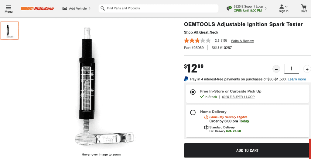

Yep, wider the gap, the bigger the spark, as witnessed by this great tool, you can actually measure your spark output before it peters out.

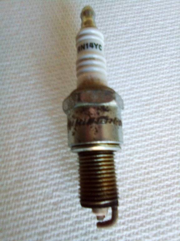

I've been thinking about replacing the plugs in my 71 360 with a set of NGK 2635 V Power as they call it (recomended as compatible on Napaonline and NGK.com). Currently I have a set of Champion RN14YC which seem to be doing ok. I don't think I'd find another set of those if I tried and have no idea how long they have been in the car. I run 91 octane without ethanol and have the timing retarded about 5 1/2 degrees from original specs. Otherwise largely an "as Built" drivetrain. Any opinions appreciated.
Thanks in advance.
I've been thinking about replacing the plugs in my 71 360 (…) Currently I have a set of Champion RN14YC which seem to be doing ok. I don't think I'd find another set of those if I tried
Try Summit. Those are the RJ14YC that I have been using on my cars.
Yes, R is resistor.
14 is the heat range, 16 is 1 step hotter.
IIRC the J vs N specifies the reach (the length of threads).
I'm betting that J is bigblock and N goes to smallblock.
"J" and "N" relate to the number of threads on the plug. "J" is shorter and "N" is longer.
There should be a "decode list" of each segment for NGK's, Autolites, and Champion spark plugs online somewhere. Only thing is that for the NGK, you'll need the "long number" (alphanumeric, similar to the Champion part number) rather than the "sales number" (4-digits). The "long number" is the one stamped into the spark plug, too. The "sales number" is the number stamped on the box the 4 spark plugs are sold in.
The "segments" would include: thread reach, heat range number, gap style, extended center electrodes, design spark gap spec, resistor, and copper core (where applicable).
In the NGKs, the heat range number increases as it gets colder, the opposite of other spark plugs, where the number increases as it gets hotter.
The other thing is that NGK heat ranges seem to be wider than other brands' heat ranges. Just an observation.
The thread reach has nothing to do with "big block" or "small block" per se, as some aluminum B/RB heads can use the "N" spark plugs, IF that's what the heads were designed to use. Just as small block Chevy V-8s can use a "J" Champion plug, too. But in the case of Chrysler-specific engines, the Js are B/RB and Ns are LA.
CBODY67
