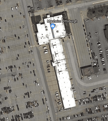

While I was laid off last summer, I worked part time Maintenance for Cox Automotive, Manheim Auto Auction. We had a very large building with a Carlisle SynTec roof, never a problem or leak. The price would obviously be more than what you will pay for the coating over your existing roof but the SynTec product has a 35 year warranty. It may be worth checking out.
