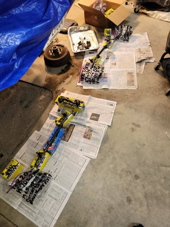

After sitting for 17 years I am going through and going to get my '68 Newport 4d Hardtop back on the road but in good form. The car is very solid and in good shape, just needs some TLC.
I have never done a front end but have my parts laid out and am moving ahead slowly as to not make (to many) mistakes that I have to do over.
Parts laid out as I move forward. - My questions will be coming at intervals.

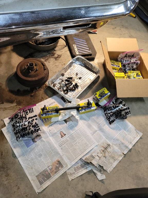

I recognize Craig's "signature" all over those boxes and bags....
Aaaahhhh....that's a "Craig kit". You won't be disappointed! I just did the entire front end on my 69 Fury (same as yours). Not a bad job. Be sure to replace those lower control arm bushings! I only say this because people often skip that part because "appears" labor intensive. The job is not so bad. Get yourself the Mancini Racing torsion bar removal tool too! You will be glad you did. If you have access to a MIG welder, the lower control arm removal, and pin sleeve removal will be very easy. I can say this for fact, as I did it two months ago.
Next step...replace those leaf springs! I did, and between these two jobs, the car is a different (much better) car!
Feel free to reach out if I can answer any questions>
