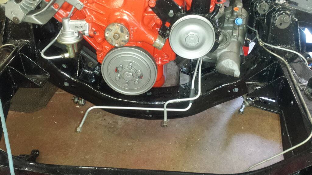

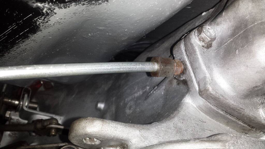

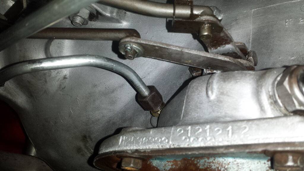

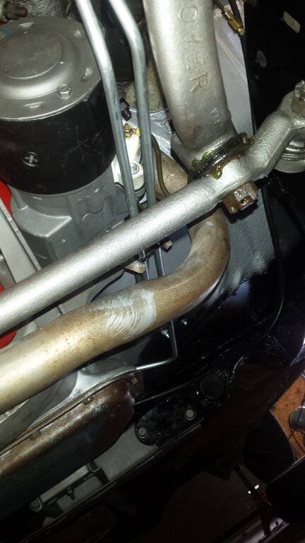

Here are mine. Not quite a full factory routing but very close
