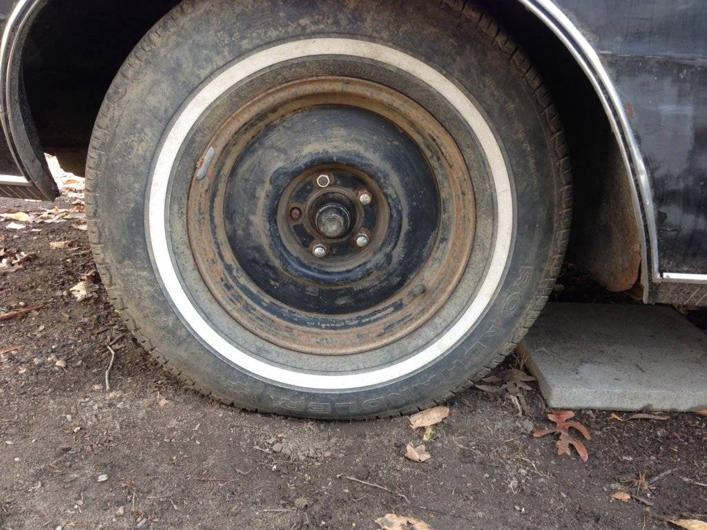

Do you mean a rim like this?

There's no mystery. They are tow package wheels.
