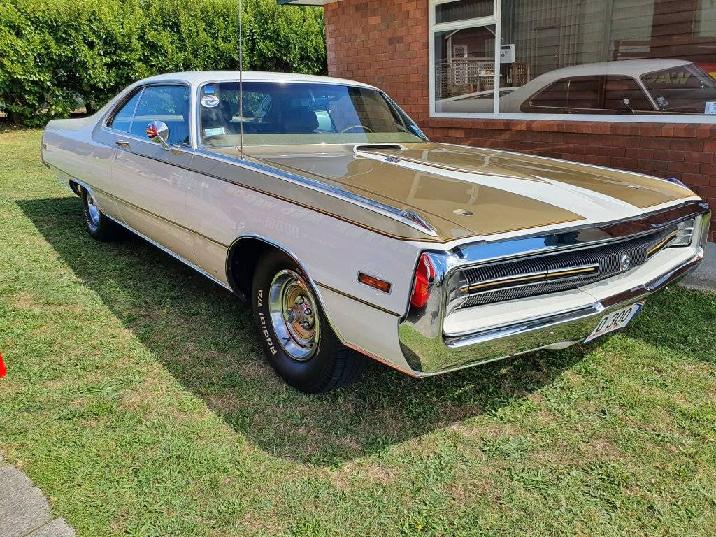

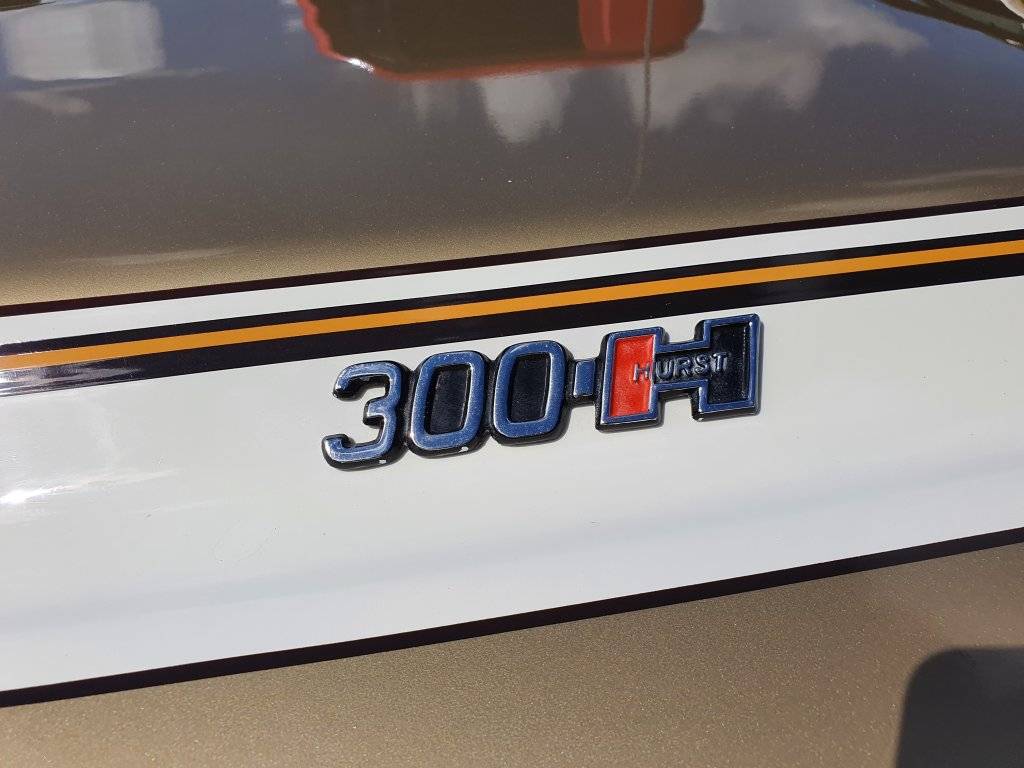

Some pictures of my bud's '70 Hurst 300

Very nice Hurst. I'm impressed at how straight the hood and decklid are, as that fiberglass often became quite wavy or ill-fitting after just a few years (1975!). Mine are good, but this car is better.
Great pics you have treated us to, thanks for posting!

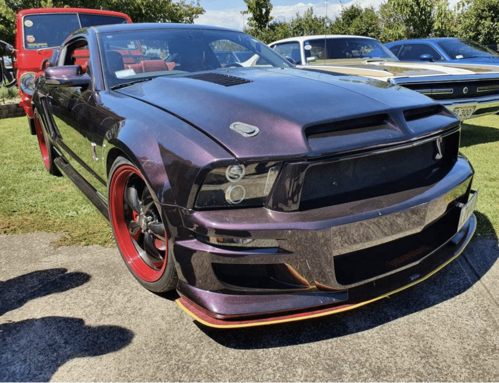

Man, how many front ends can you put on a car? Sure makes the Chrysler 300 Hurst look even better in comparison. It looks like it's moving even when it's standing still.
I like Stangs, (even with multiiple front ends.) I think with today's high chrome prices, the needed safety regulations and low incomes forcing people to buy one vehicle that can do everything (suv's and trucks), todays designers are all out of ideas.

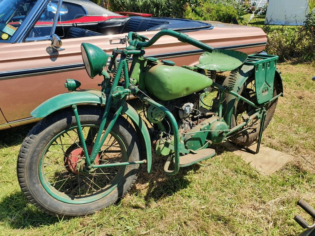

Wow, what a gathering. Looks like there were some cars and people out there. Out of curiosity, can anyone identify the very green motorcycle?
I like Stangs, (even with multiiple front ends.) I think with today's high chrome prices, the needed safety regulations and low incomes forcing people to buy one vehicle that can do everything (suv's and trucks), todays designers are all out of ideas. View attachment 521014
I think the safety regulations are a part of the reason cars are so expensive now. More expensive though is probably the infotainment nonsense they put in the dash, and the ridiculous parallel-park/panic-stop/lane-assist for you gimmicks... Don't even get me started on the price of all those cupholders XD
