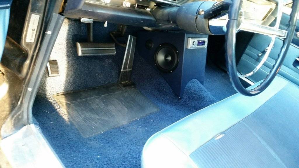

Here's what I did. No cutting at all.
20150722_195051_1473186035823_resized-jpg.91699
No, you had to cut a fab a center control panel. Some people don't have that capability, time, and/or tools to do that!
Sorry stubs... I have seen plenty of expensive stereo shops build stuff like that... particle board, $20 sabre saw and a little patience to fit it and cover it (glue and staple gun)... I like it because it's not damaging and could be built in an hour by someone who had already made a cardboard and tape mock up.
It would be lots more effort to wire and install into door panels or the package shelf.
Acoustically this is all wrong, but isn't the point to get some music without hurting the car? nothing easier than dropping wires under the dash for it, OneEyed, you get a thumbs up from me.
That is true! But if I didn't have the capability, tools or the time...then having this car is completely irrelevant.
Also, it IS acoustically incorrect. But, it DOES sound better than no speakers at all and I was able to fit a normal DIN stereo in it which was my primary goal, the speakers were more of a bonus. I have a matching set of 6x9's in the rear deck as well. Amps on all speakers. Adjust the fader a little and its really not that bad though. But then again, this car was never designed to be a rolling concert hall. That's what my other car is for. ;)
Plus I can pull the whole thing out and you'll never know it was there.
