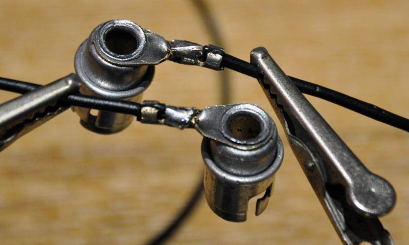

I did the same on a few other parts as well, when they were not replaceable, like on the fender mounted turn signals.

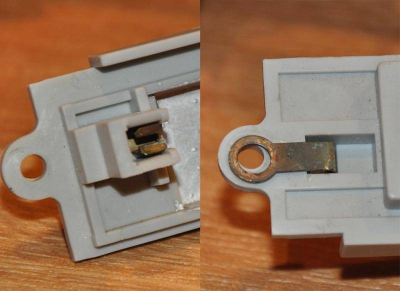

But I experienced corosion problems inside some old terminals that caused in no continuity at all. Like on the instrument cluster illumination.
These terminals are a two piece part, slided together. And you can't part them without breaking them.

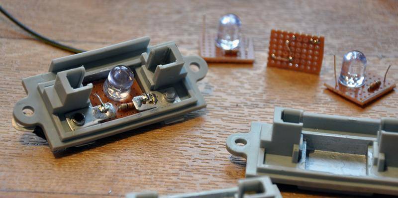

That's why I made my own LED boards to replace the original sockets and bulbs.
Buuut, long story short. I will open up the old terminals and solder the new cables in place if I can't find new terminals.
I contacted Andy Bernbaum Classic & Vintage Auto Parts Online| Restoration Mopar Parts and he guided me to Rhode Island Wire (www.riwire.com) and told me "they will have any connector your need".
We will see.
I was going to suggest just soldering wire to the studs and be done.✅
