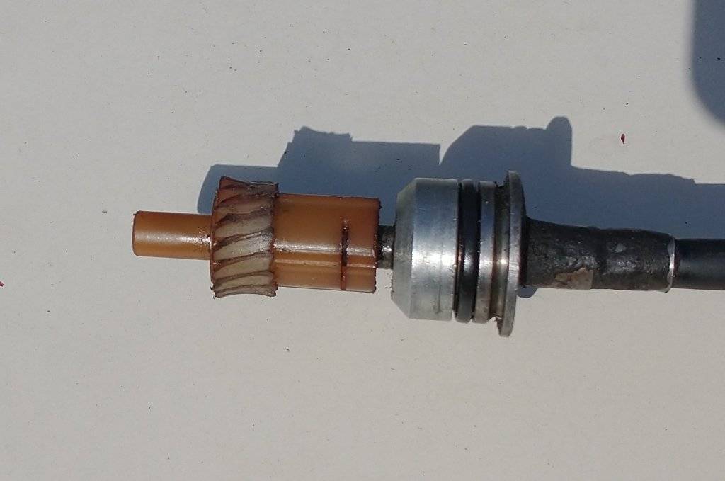

Alright guys, Check this out.
We pulled the speedo cable and found this.
So naturally I thought "well, we just need a new speedo cable and gear.

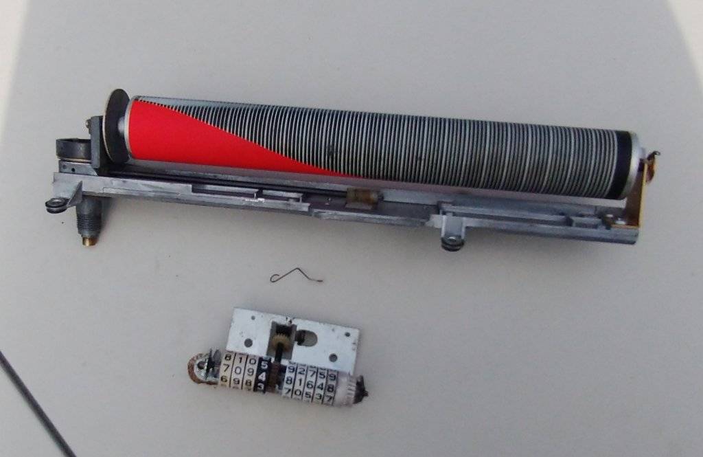

After a bit of trouble shooting I realized that the cable won't turn the speedo by hand. Meaning with the cable pulled loose from the transmission it won't turn.
So, I decided to pull the speedo itself.
The cylinder and spring all seem to move freely.
The problem seems to be where the cable goes in.
It's seized up or broken somehow inside.
Is this part fixable, replaceable or should I just get a whole new speedo?

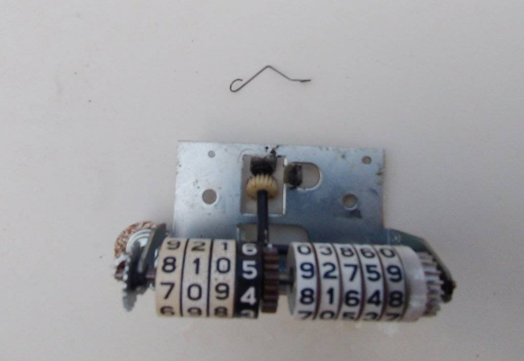

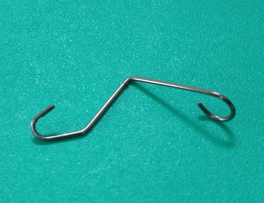

Also, when I took it apart the little spring off the odometer fell out before I could see where it goes.
Can anyone tell me how it goes or point me to a resource?

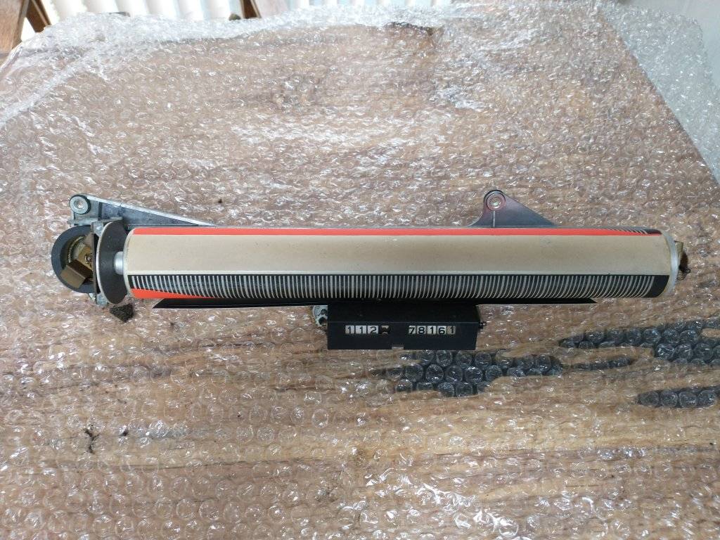

I got a new speedo from the amazing Murray Park today.
I went over it carefully and I don't see that spring on it anywhere.
Maybe it came from somewhere else. :confused:
I installed it and it is working fine. I switched the odo's because I want the mileage to be accurate for this car.
We have a working speedo and odo once again.
Thanks again Murray Park. :thankyou:
Yay Murray! I just checked 3 instrument clusters and see no sign of that little spring.
