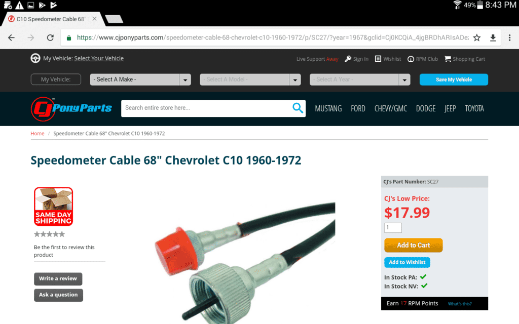

If anyone is interested belive it or not a 1966 uses a 1/2 " nut on the back of the speedo and a 1965 uses a 5/8 " nut the transmissions are all the same from 66 up they take a 7/8" nut . You won't belive what i found that fits perfect and the right length. Here is a link.
