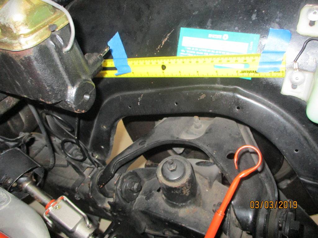

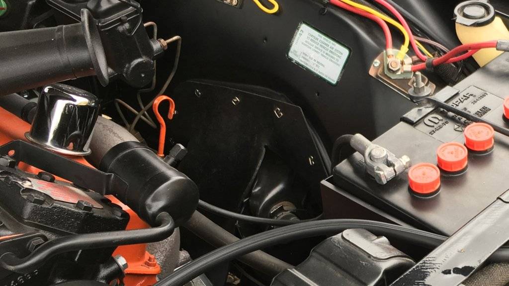

I've been installing Detroit Muscle's excellent Mega Shield Kit. Mopar C Body 70-71 Plymouth Fury & Sport Fury MEGA Splash Shield Set Everything is a flawless fit, until I came to the final "piece de resistance"....the A-arm shields.
Here's a pic of my fenderwell opening, and a pic of the DMT item. Obviously it's not right. I got with Jim F. at DMT today, and he doesn't know what the heck is going on and asked me if I or any of you guys have a good pic of the correct shield, out of the car.
I'm guessing that this Mega Kit for the Plymouth model uses the A-arm shield I've pictured below. Otherwise, everything else in this kit has been perfect for my 300 Maybe because these A-arm shields are correct for a Plymouth and not a "Torsion Quiet" Chrysler? Can anyone help DMT out (and me!) with getting a good item to template?

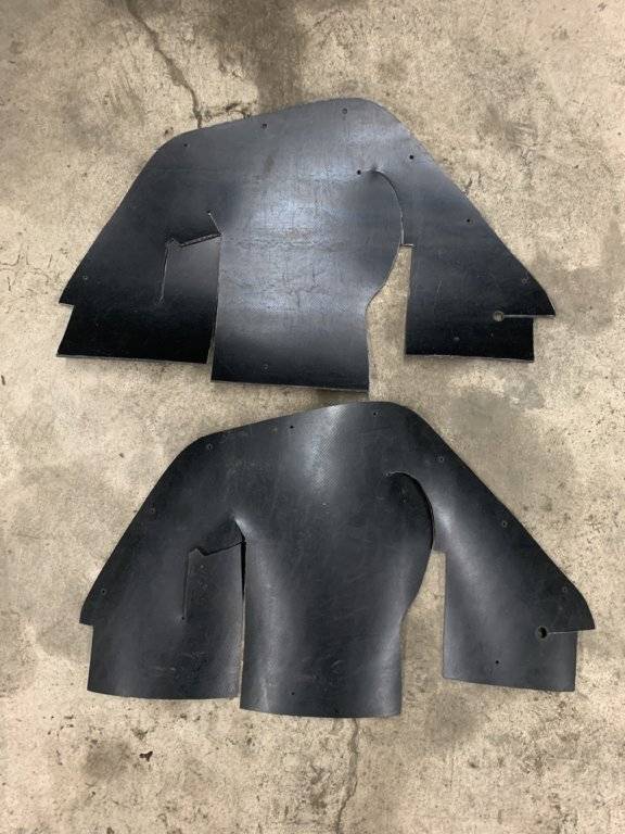

This is what they should look like
DMT C Body 1969 69 1970 70 A Arm Torsion Bar Rubber Splash Shields Fender Seal | eBay
I used these on my 69 and they fit perfectly.

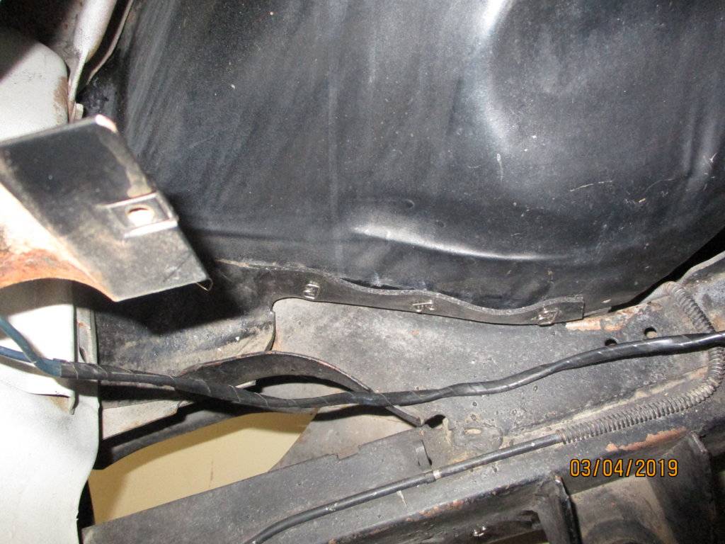

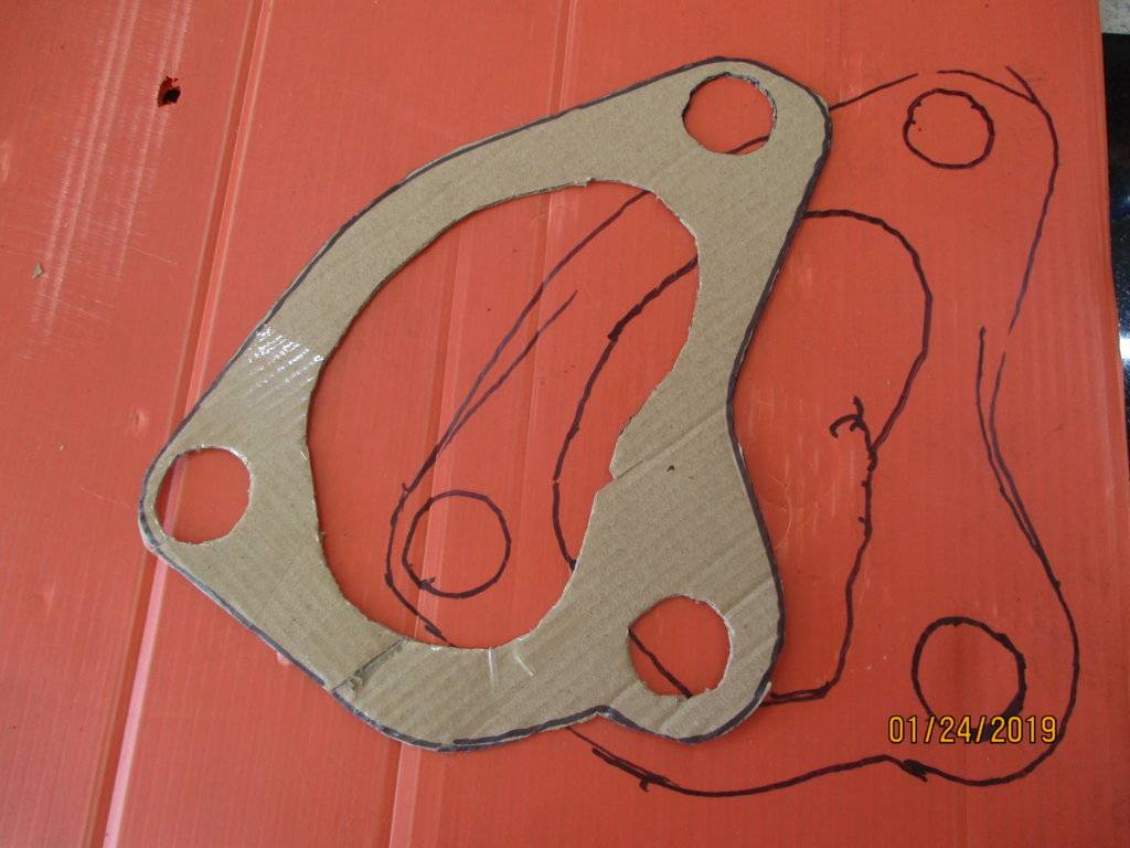

I know (I should say "I believe) you worked with Jim on the shoddy pad (I have it, too), but what you linked to can't possibly be right for my car. Please look at this fenderwell pic again. You'll notice only 8 holes (5 are visible). I templated it today so I can cut the stuff DMT sent me and make my own if he doesn't have it somewhere.
Here's the passenger side.

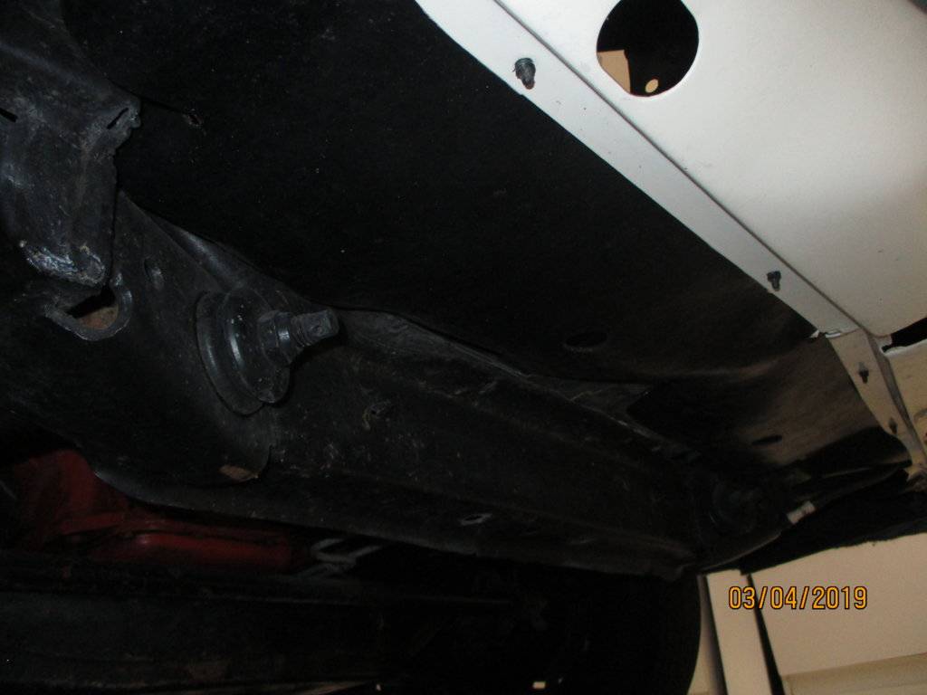

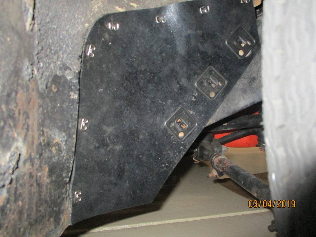

The installation is a little tricky as part of it lays over the control arm and clips to the stub frame, I'll get a picture of mine when I get home in about an hour.
My inner fenders look just like yours.

I'll take a couple pics of mine tomorrow. Don't cut it up.

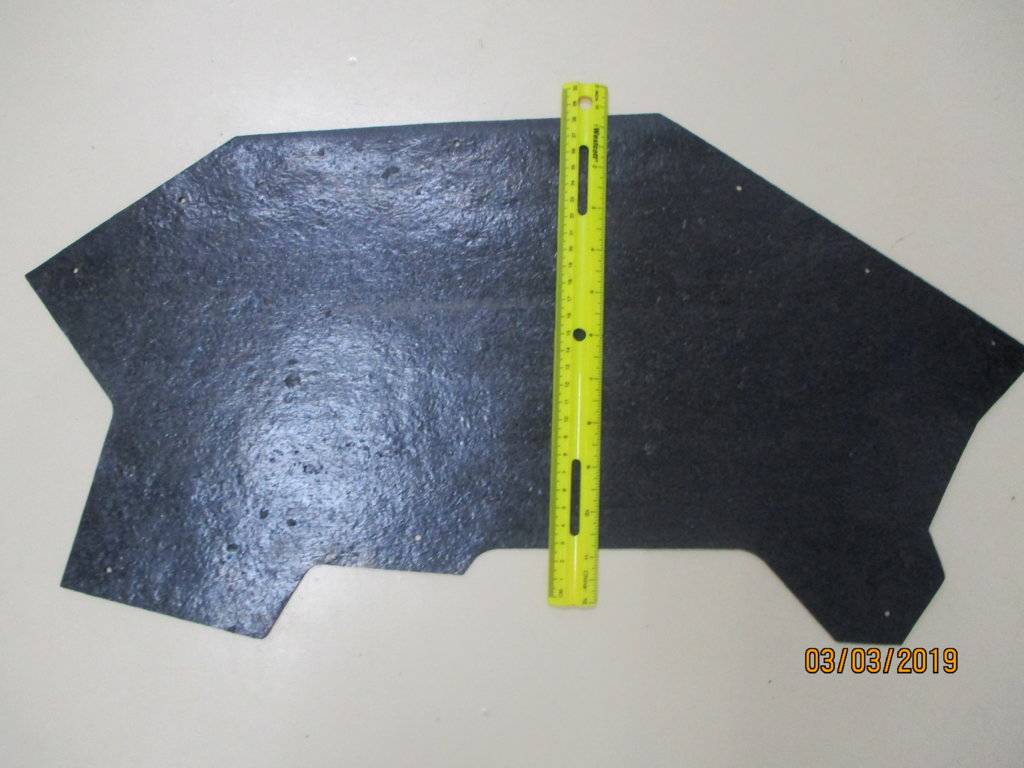

You mean the piece that I have with a ruler on it? It CAN'T be right. I hope you're right and I'm just not seeing it.
You might be surprised, walk it on from the rear, it looks like it might balloon out over the control arm, a different piece than the one I posted but said to be correct for some cars.

Yea, I think it's right.
It's too cold for garage photography tonight. I'll get it tomorrow.

I'd be surprised all right, cuz I tried the "walk" yesterday. I'll have another look, but everything on the DMT piece has sharp angles (and 9 holes) whereas my opening and the recessed channel that it fits in is curvy.
And the item you linked has 12 fasteners. I ain't got that fo' sho.

Here's a pic that Jim sent me. It's what he used to make a 70 300 kit. The old A-arm shields look very similar to the ones in my Mega kit, so maybe Big John is right. Weird.
I still think you have the correct ones for your car, you just need a picture of them installed.
