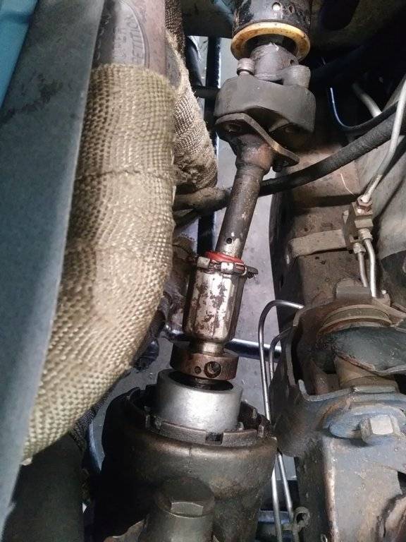

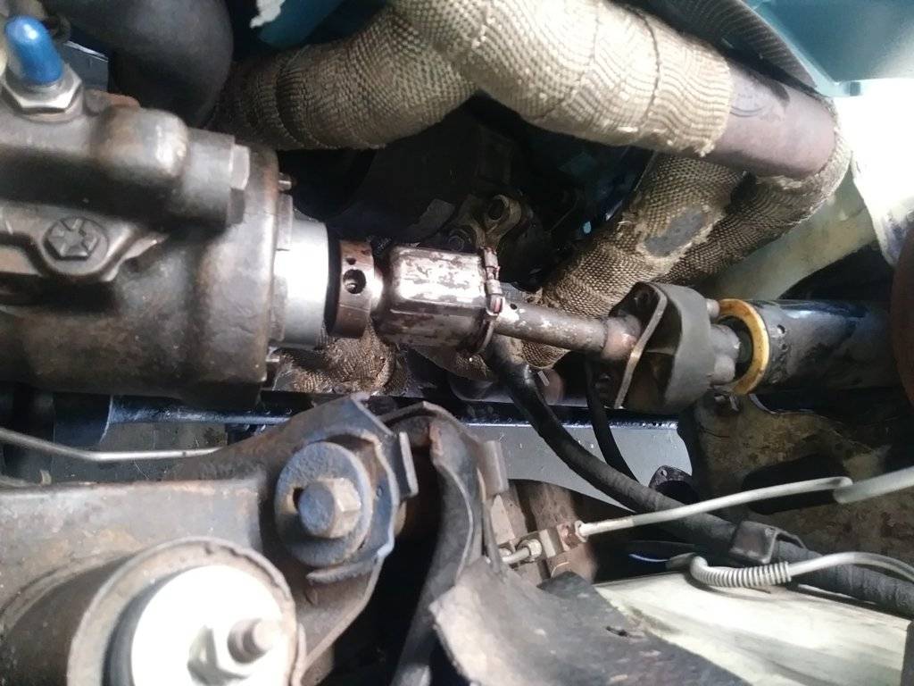

My main point in the first pics is to show the angles of the assembly before changing anything. (Grapefruit sized black cover removed on steering shaft near firewall.) There is no straight line, and yet, it didn't seem to make any noise or rubbing sounds.
And, there was no binding to begin with. The steering was never in question, except for the extra slop (today's standards) that I have ever felt since even my first experience 53 years ago in Dad's 300.

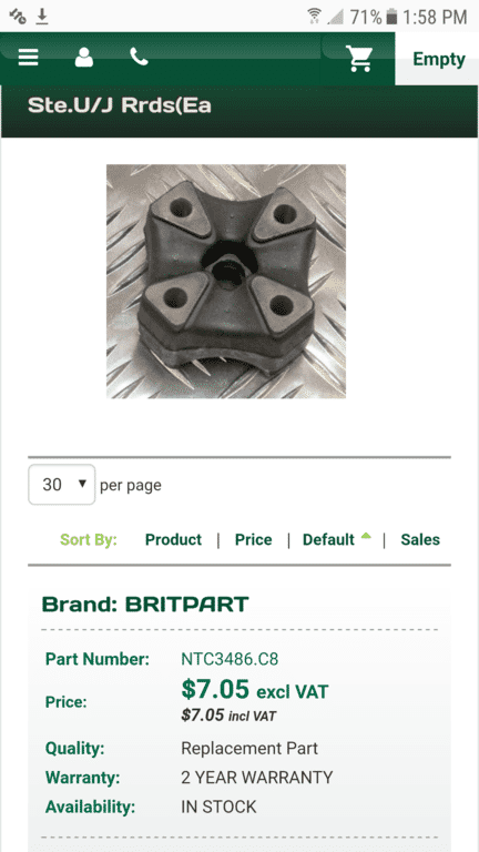

Only two possibilities existed, reasonably speaking: the British designed couplers. There was no way I was going to spend for a very old piece at a ridiculous price.
Sadly, there is no recently manufactured American part, so, next best thing is import in this case. Taiwan is making the Triumph (150696) and Land Rover (NTC3486) parts.
I went for the British Leyland designs, choosing the Triumph (150696) at British Parts Northwest (British Parts Northwest - Quality Parts For Austin Healey MG MGB Triumph TR6) over the LR part, because of the extra counter sunk holes.
It made it WAY much easier to continue the drilling with a 29/64 drill than to worry about centering for me.

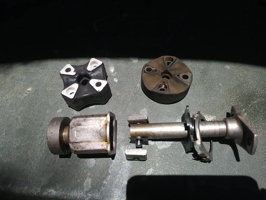

Continued from #106. I shaved off about 3/16 on each side with a cutoff wheel (like butter), and resunk the two holes on each side to match the heads. Done in less than 30 minutes. See pics.
The LR part is cheaper, yes, but the centering and easy/quick resink was worth it to me. (BPN sell both, I think.)
Plus, the cutoff wheel went a bit faster on four of the eight counter sunk holes.

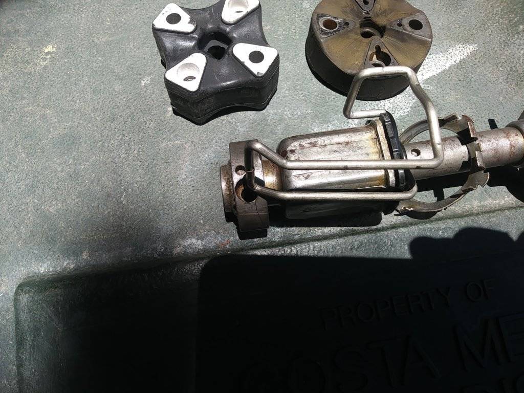

Finally, as you can see from Detroit Muscle Technologies (Mopar & AMC muscle car restoration gaskets Detroit Muscle Technologies, LLC) the clip (3") and the EPDM BLACK rubber seal - to add some belt and suspenders to the peace of mind!
(I moved the center shaft to one side as I replaced the BLACK seal, thereby not having to stretch it. It is really tight on the shaft! Note the shaft and steel coupler orientation - see leetle holes line up.)
There will be no grease coming out and very little O2 coming in to react with it. :-) (The ingenious idea of putting the Zerk grease fitting did not go unnoticed!
I am saving that for future endeavor. But, I was already ording the BLACK seal, so, I just added the clip from DMT and sort of get 1.5 times the solution of just the fitting.)
