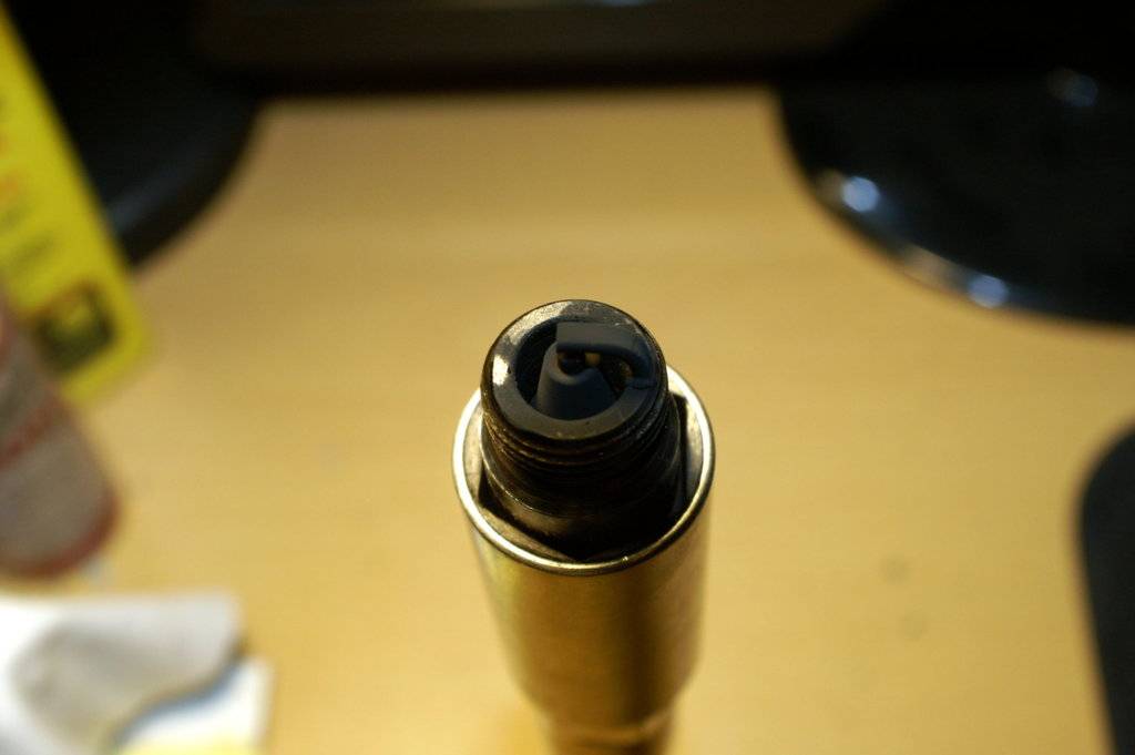

After re-adjusting the valves for the second time the car started right up and ran for 4 minutes before it stumbled and died at idle. Noticed a light haze coming out of the carb and that the secondary venturies were wet. So I pulled a plug and this is what it looks like after 4 minutes. Kind of rich being all black. Carb has 48 jets in the primary which was standard for this application. I'm guessing the float level is somehow off by a wide margin now.
