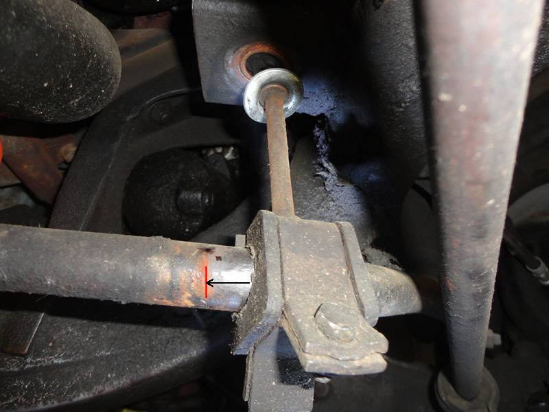

This is my driver's side sway bar link. The bottom square bushing needs to be slid over.
The top bushing is almost non-existent, and the retainer is mangled, but the real problem is the big gap where the link has slipped down and out of position.
This is the passenger side. This is what everything is supposed to look like.
So here is my question: removing the driver's side link and replacing the top bushing looks pretty straight forward, but what about that gap? As is, I don't really see how I will get that link up where it is supposed to be. Should I push the sway bar up with a jack to close that gap?
No suspension parts appear to be bent, but I have a few other bad bushings -- the upper control arm bushings are shot, which means that the upper ball joints are also probably bad, and the forward strut bushings are torn.
I guess what I really want to know is if I can fix this myself in my driveway, or does that out-of place link in my pictures indicate that I should have this repaired by a shop?

The interesting thing is that it looks like somebody already replaced just the left one as the right one doesn't look to have the bolt on the lower part.
I'd be looking at everything to make sure nothing is bent or that the bar is centered, look where it clamps to the struts on each side.
Alan
There's guy's that use the sway bar as a pulling point. The one in the pic is bent!! It needs replaced. Just swapping bushings doesn't repair a bent part.........

Okay so I did a little more looking and a little preliminary work on the bad link. That link is perfectly straight and good. And the sway bar looks perfectly straight and good. I think that maybe all of the sway bar and body strut bushings are worn just a little, and that some of the bushing "straps" may have twisted a little, and that all together it is causing the sway bar to be a little off level, resulting in that big gap where the link bushing is supposed to be in my first two pics.
I think saylor nailed it when he suggested loosening everything up and changing bushings, and thanks again for the link, Moog K7061 & K7064 are exactly what I am going to use.
And BTW, regarding the link square bushing "strap" that is welded, not bolted -- you can barely see in my original pictures that the passenger side link strap still has the weld, but the driver side link strap has already been cut/drilled and bolted back up (good eye MrMoparCHP!). So, it looks like someone before me only replaced one of the two square link bushings.
