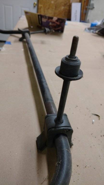

OK, let me crawl under Tilly 1st thing tomorrow morning and get a shot. Here's a pic of a swaybar with the appropriate links on it. Mine are just this kind:

Jerry since we can't post pictures in conversations, I thought I'd go ahead and post my sway bar picture here. It is in better shape than I remember I'd have to cut that hard rubber bushing off to get a kink off the sway bar.

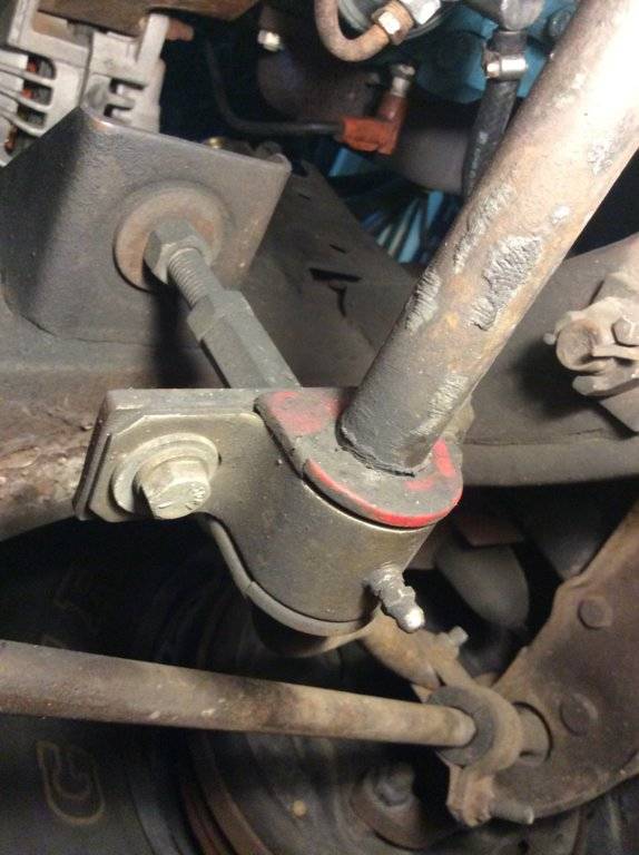

This is what I did when I rebuilt the front suspension on our car. The sway bar bushings came from Autozone. A couple of coupling nuts from Fastenal some 1/2 all thread a piece of flat bar some welding and other hardware.
Your approach to the Energy/Prothane Suspension mod is very similar to what I've thought on a few times. If its too much hassle for you to get your old link(s) loose, keep them. I'd use a drill on that hard rubber if I were determined to get the link loose, but one must be careful! I did that with the old rubber on one of my links last year and it worked well enough. I might use a rod coupling on the old link, by cutting off the bad thread, run a die over the smooth rod, then a bit of 5/16 -18 all thread or even a long bolt (I want #8 grade steel, not 5!) into the coupling to get it up into the old hole for the bushings. Anything beyond that warrants doing something like what you did.
This sort of solution has occurred to me ever since I got Mathilda Mar, 2016. Strut channel has appeal here too. As an old electrician, I know a few tricks with strut and straps. I might try a strong 1 hole rigid pipe strap, say, 1.25 - 1.5" with some poly bushings meant for 7/8" bars. A few good heavy fender washers, hard all thread rod or long bolts, possibly rod couplers, and it should be easy enough to contrive good substitutes, considerably cheaper than $50 apiece.
