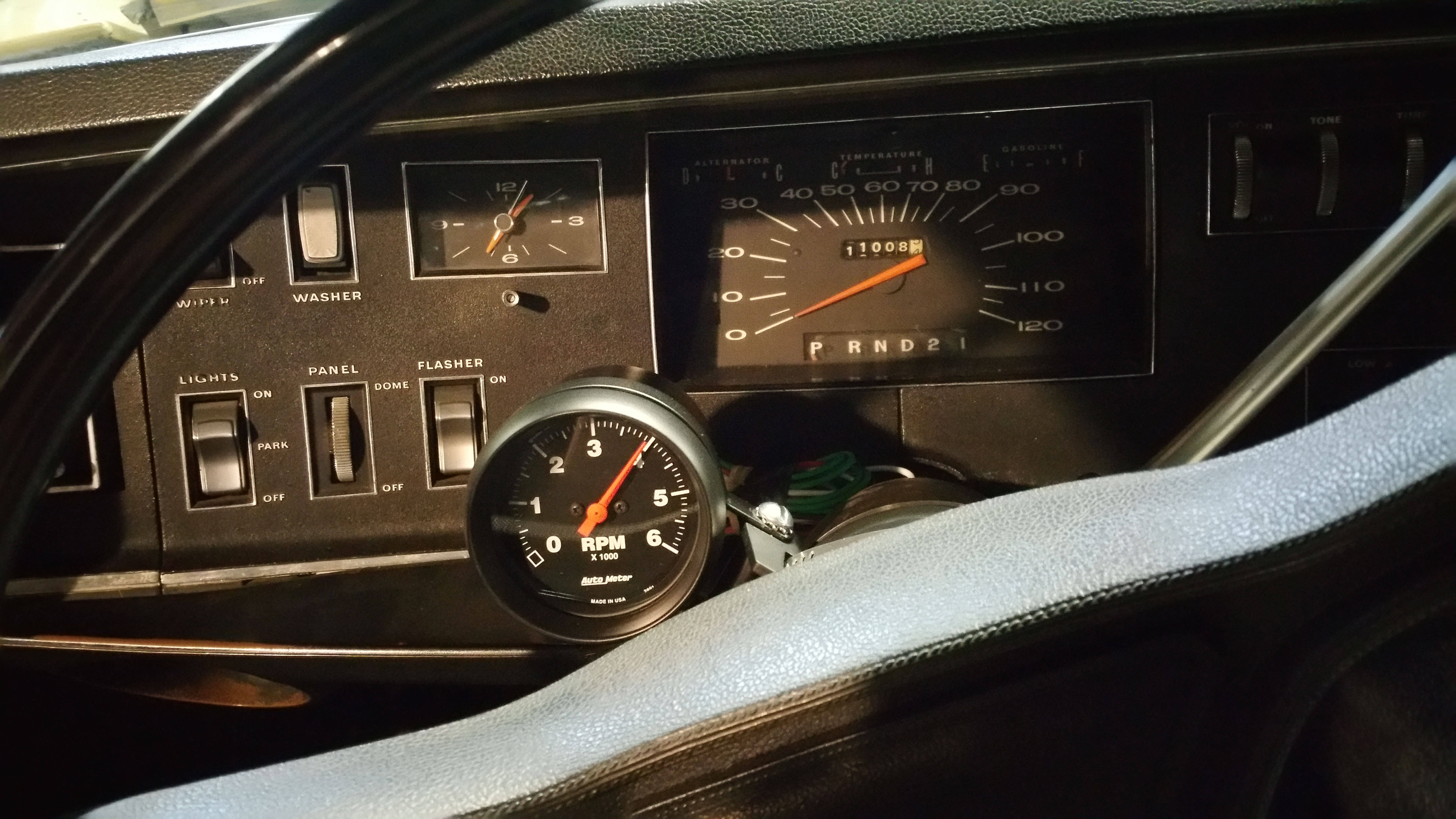

Well I mocked up my tach. Too cold to hook it up and my Fury is down for the winter anyways. [She watches re runs of Highway Patrol in the garage!] I wanted one as I am curious what rpm's on the highway and my speedo is off. The autometer tach is small [2 5/8ths] with no shift lights and alarms and no red line. It will only read only to 6000 which is fine for my stock 440. I tried several times to have the pic posted here as I have many times done in the past but today all I get is in a file. I still have to re position it a bit but you get the idea.
Your 5312x2988 picture is too large. I just resized it. :D

Hey Thank you rag300! How did you do that?
