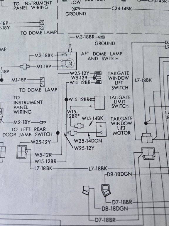

So, the tailgate motor uses a chassie ground. Took one lead of "shotgun" energizer. A 12v battery with a momentary switch in series. With two alligator clips on the motor end. Grounded the negative to the regulator frame mountin stud, had shiny metal threads for good contact. The other went to one of the motor leads, being challenged, started with the ("Red" in correct) Dk Green motor lead arms went down. Switched to the black and the arms went up. So chassie grd it is.

What year car are we talking about here... I have to go look at a wiring diagram now.
That surprises me... All the other window motors don't need to ground to the chassis.
Sorry.... I should not have assumed they were.
69 plymouth wagon. When I looked there was no grnd symbol attached to the motor. Just the two leads one through the limit switch tied to the Brown at the key switch. The other Dk Green connected to the yellow wire back to the key switch as I recall. Red home runned? I'll look again as well, outdoor xmas lite time.
