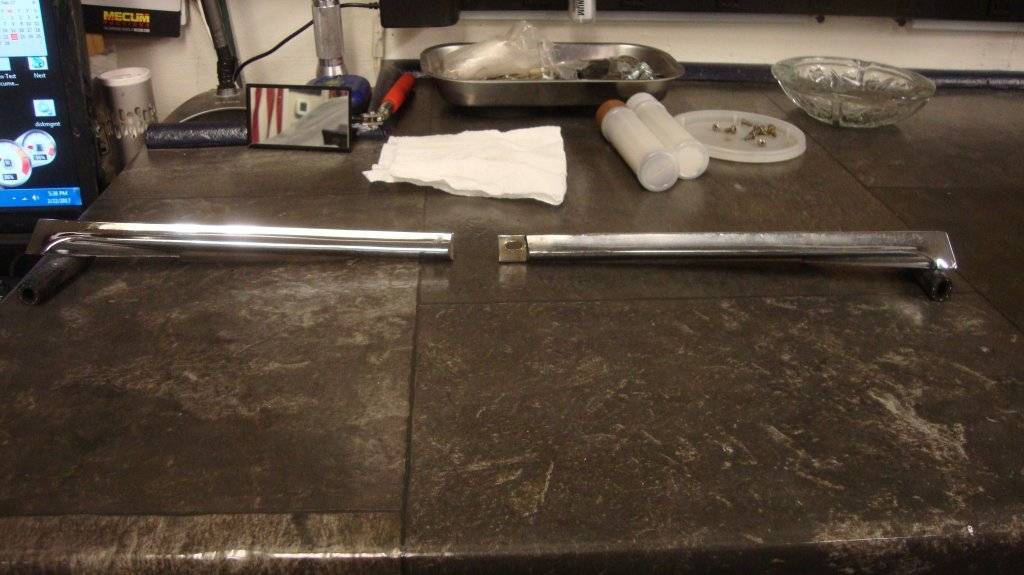

is there any "safe" way to take off this trim piece without breaking the clips underneath? (these type of trim clips are what hold on the side mouldings as well)

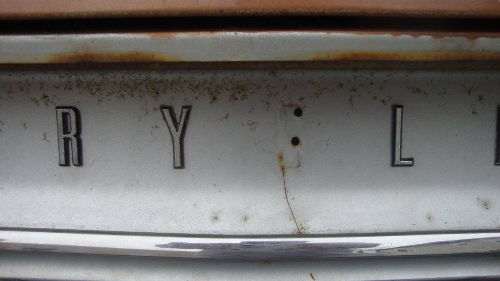

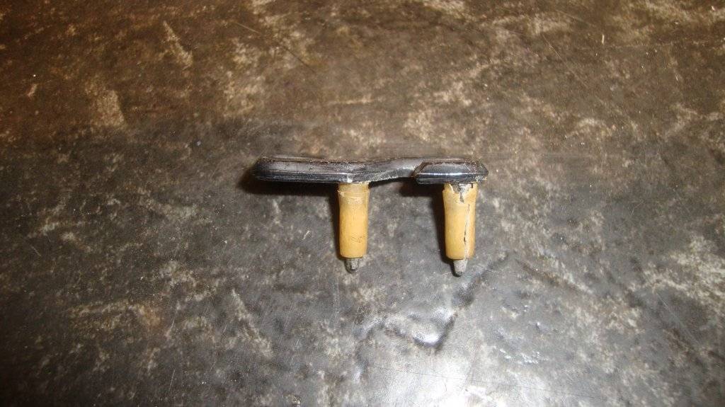

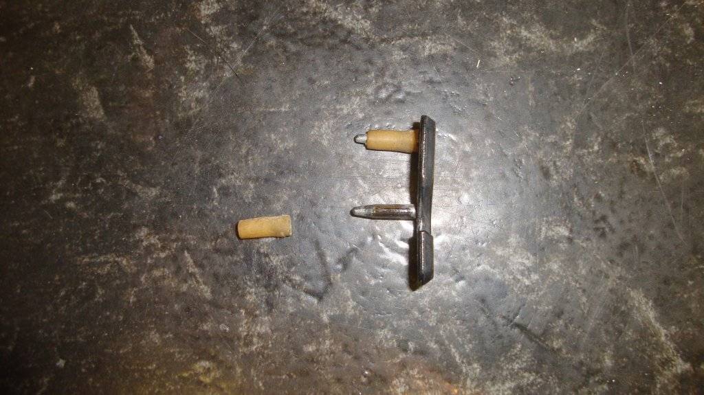

the letters in the "tail panel" are held in by these plastic "plugs." has anyone come up with a better, stronger way to hold them on? (short of gluing the letters to the panel) I have all the letters currently and am afraid that once I pull them off, I may break said plug and either not be able to put them back on, or lose a letter (or all the letters) after I re-install them...

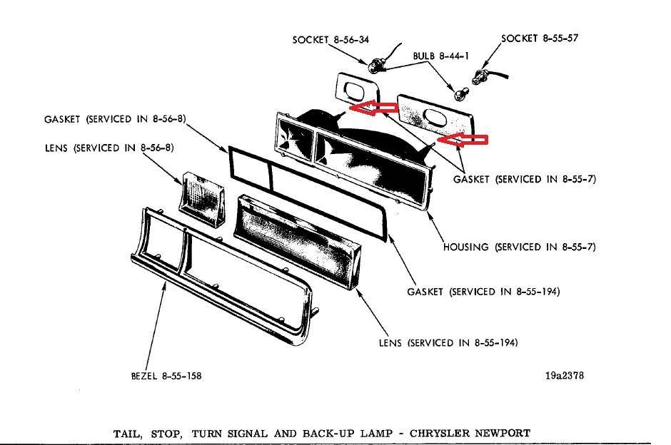

lastly, how the $%^& do the tail light bezels come off???

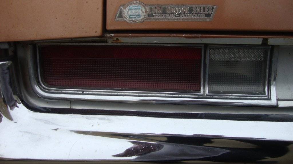

a couple pics of the handiwork so far...
right is before, left is after...
the piece that sits on the lip of the trunk...

the plastic sleeves for the letters area one time usage. going on and never coming off...
Try to source the sleeves or hot glue them back into place or use the speed nuts available at an auto parts store.
you have to drop the bumper off ot get those beezels off Mario...
was planning on dropping the bumper fer paintin', Tommy. so how do you get them off? crowbar?
gotcha. I would love to use speed nuts, but I cannot get to the area behind the panel. it is "walled off," as it were. A big, beautiful "wall," but a wall nonetheless. lol
I think Im going to try the sleeves Big John suggested. I did a measurement and it looks like they will fit. although a dab of hot glue is not a bad idea at all...hmmmm
Hot glue or find them online

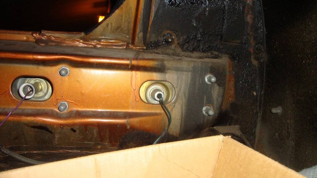

Don't the tail lamp assemblies bolt on from inside the trunk? I would say that you will have to remove the whole tail lamp to get at the bolt/screws that hold the t/l bezel to the t/l housing.

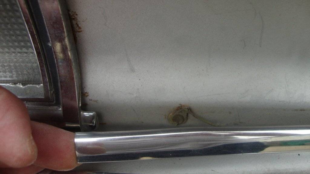

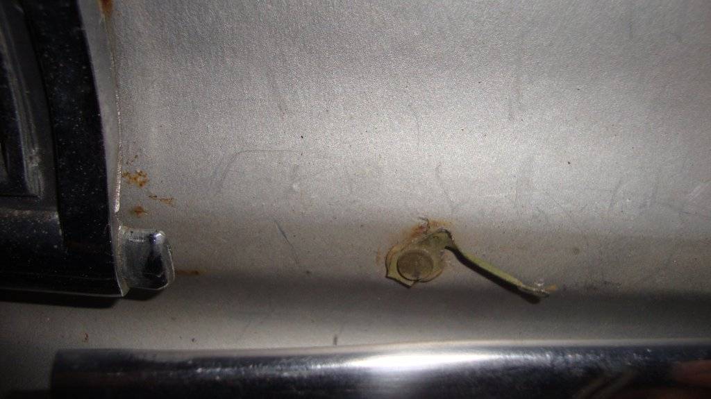

The moulding clips are either going to have a nut on the backside, or you will need a tool to "unlock" the tail of the clip from the moulding so that the clip can be rotated and the moulding popped off of it. It's not as easy as it sounds.

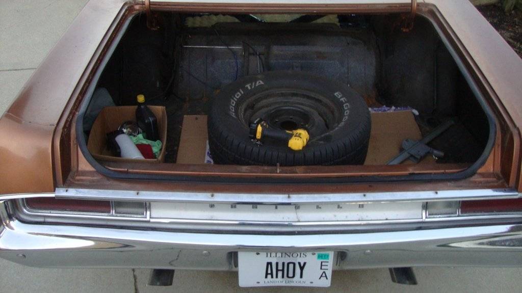

And put picture of rear end without lights etc. Im planning 300 taillight swap to my Newport and want to see how it looks without lights etc.
yikes. well, ill take a gander and see...
regarding the clips, what kind of tool do you suggest? I have some plastic tools I got from Eastwood, but not sure which one will work best.
will do

will do

Those clips really look like they should have nuts on the back side of them, which will be a LOT easier than trying to get them "unlocked" from the moulding.

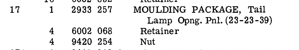

So are the clips accessible from the backside? They have to either be accessible from behind, or snap into place.
The clips have to be accessible from the backside since there is a nut listed for the clip.

The tail lamp housings have to be accessible from behind also. It looks like the bezel bolts to the housing, so you're going to have to remove the lamp assy., and then you can take the bezel off of it.
I can unsnap the clips from the front. though they look like they are tacked in place. I will take a pic shortly

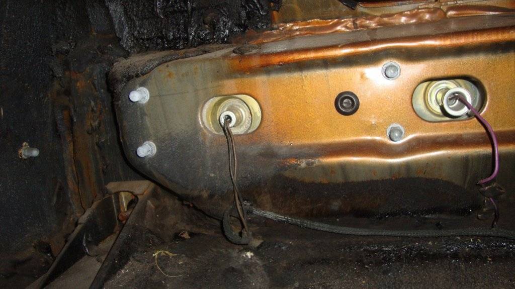

IIRC, there are barrel nuts on the backside of the tail lights in the trunk. I will snap a pic of that as well.
I was hoping not to have to take the entire tail lamp assy. out to get the bezels, but it looks like I must.

so it does look like those clips could have a nut on the backside...hopefully I dont break any of em when I take the trim piece off. lol
yep, barrel nuts. well, that will make it a lot easier to take the lights out. lol
Well, I received the plastic sleeves (trim retainers) that Big John suggested, and it looks like they will fit...I will confirm this once everything is painted and ready for the letters.
